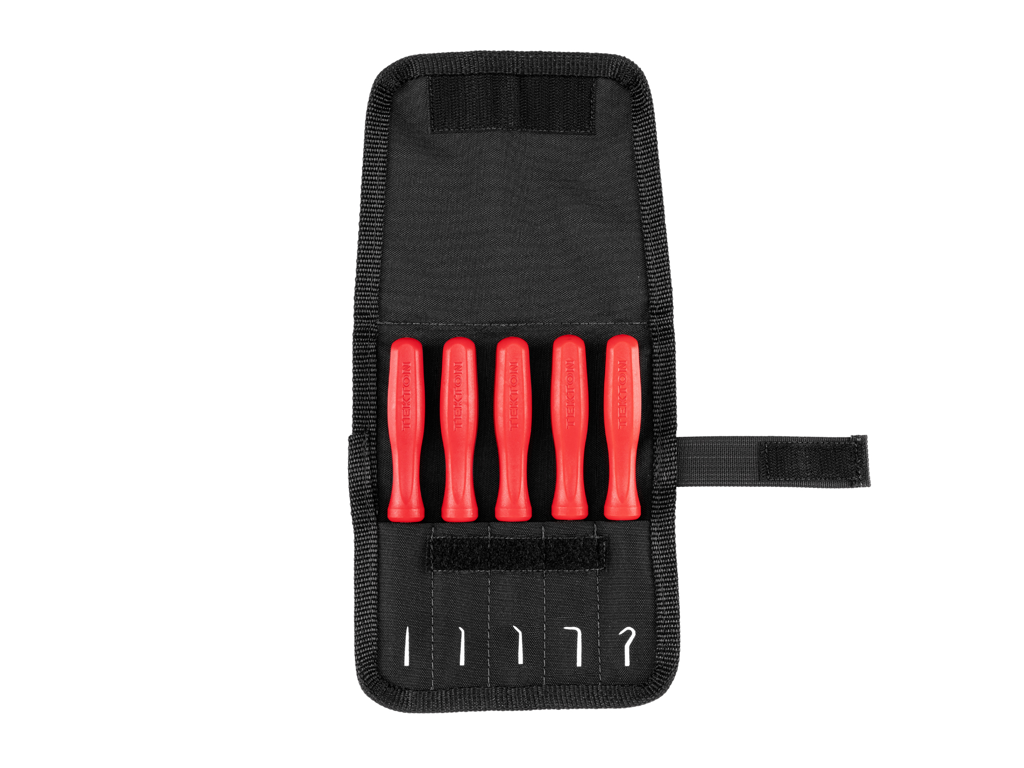

Tekton sells a set of 5 for $32 with a pouch and $20 without the pouch. These are available as sharp or dull points. I have the sharp points. The Tekton’s are Manufactured in Michigan (USA). I own a couple sets because I just did not like the handles on the harbor Freight and I really like the pouch.

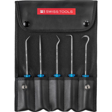

PB Swiss has the Multicraft Pick Set, 5pcs, w/ Roll-Up Case (PB 7685) for about $60. This is also available with the softer SwissGrip handle (PB 8685) for the same price.
I purchased a set of PB 7685 with a damaged roll for $30 and here they are:
The Tekton can be “rolled” (folded in half) and held in place with a built-in hook and loop (Velcro) fastener. The case has a Polyester Fabric with a “durable water repellent coating”. This material is very durable, both abrasion and tear resistant. I can attest to this, I really like it.

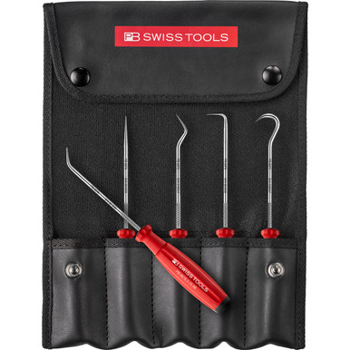

The PB Swiss has a “compact roll-up imitation leather case”. Again, “roll-up” means that you can fold it in half, but, without the Velcro it opens immediately. The case is smaller (good) but not nearly as durable. My set was reduced 50% because the case was damaged. You can see the damage where this fake leather has ripped (lower right and lower second from the left). The rips look small but they are pretty deep. Based on the original packaging, it looks like this set was run-over by a forklift. I think that the Tekton case would have held up better. The PB Swiss case is not (in my opinion) abrasion resistant.
If you unfold the Tekton (but leave the flap closed), the shapes are “heat transferred” onto the case. Even closed you can tell what picks are in the case. PB Swiss uses snaps and Tekton uses Velcro to hold the flap closed.
The Tekton are stored pointy side down and the PB Swiss are stored pointy side up. Opening the flap shows the picks directly on the PB Swiss and you need the heat transferred labels on the Tekton are required to identify which pick is where.

The picture below demonstrates that I have two mismatched (out of order). From left to right these are:
  • straight / straight
  • offset / 45
  • bent / compound
  • 90 / 90
  • hook / hook
The PB Swiss handles claim to work well with oily hands and is highly impact resistant. The handle material is Cellulose Acetate Butyrate (CAB) made from “renewable cellulose”. Taken from https://www.pbswisstools.com/en/about-us/quality/high-grade-materials we have:
Cellulose acetate butyrate (CAB) is a natural material derived from wood which we use for crafting the PB Swiss Tools Classic and multicraft handles. Since CAB can develop an unpleasant odor in airtight boxes and drawers, we add a subtle vanilla fragrance to the material to neutralize it.
So it is not uncommon to see people smelling the handles (at least in my house).
The Tekton website indicates the handles are made of glass-reinforced nylon resistant to fuels, oils, and chemicals. You should not have a problem with cleaners and solvents and are impact resistant.
Tekton has an AISI 8650 steel shaft (Ni-Cr-Mo alloy) hardened to 50-54 HRC, which would be soft for a knife steel but you do not want it to snap so this feels like a good hardness (my non-professional opinion). At the base, these measure close to 1/8" (3.1mm) with my calipers.
PB Swiss uses a special alloy based on spring steel, exceptional elasticity coupled with high grade hardening, which again in my opinion feels like a good choice. At the base these measure at 3mm so slightly narrower than the Tekton.
Tekton says nothing about this, but, the black coating (anodized???) should help prevent rust.
PB Swiss does not appear to have any coating but it does have a decent knurling near the handle. They may be chromed but I do not know.
I prefer the feel of the Tekton in my hand and my wife prefers the feel of the PB Swiss handle. This is mostly related to the handle size (see picture). The shafts are roughly the same length.
I have to be careful inserting the Tekton picks because the sharp versions can catch on the case while inserting.
