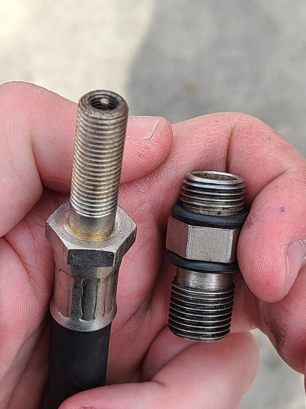

I have a mint condition MAC ct60 compression tester that has served me well and I want to stay with. The issue is that for some engines the 14mm thread is way too long. Tried to use it on my outboard and I luckily hand rotated the motor to find out the piston was hitting the adapter. Any known cheap replacements for the end?
I know there is a set of cheap adapters at Oreily to expand to many other thread types but it is based off the 14mm being the male thread that it mounts on......I need a new 14mm: https://www.oreillyauto.com/detail/...rformance-tool-compression-tester/pfm0/w80577
If not, I will use a few washers and orings but would rather have it nice without having to replace this with an offshore replacement.

how about just shortening he threads on the adapter you have?

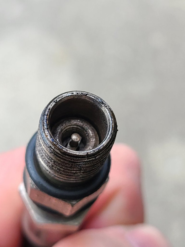

The schrader valve pretty much starts immediately (I'd run out and look but this crazy April snowstorm is going on right now).

The unknown is how thick the end where the Schrader valve threads are some have a hole drilled the size of the threads only as deep as the threads go then open up to a larger size for the hose attachment, you mat be able to tell if you take the valve out the probe to see if it's possible to cut off and rethread the Schrader.

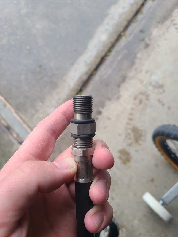

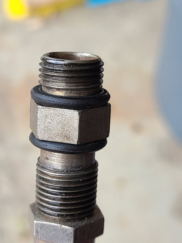

Ok, so I was wrong the schrader is recessed. But there is no need to make the threads shorter since the other side is also a 14mm (I thought that might have been the case). So problem adverted....will probably pick up the $10 adapter kit from O'reily next time I'm in there just to keep the bases covered. Thanks for all the tips.
