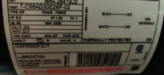

It's interesting to me that the wires from the pressure switch to the motor itself look a lot smaller that the supply wires?
This one does say 5hp on the label....

you can't compare the 2. Thats a false equivalency. The wires on listed equipment have been tested in a lab, they aren't ran inside the walls of a building next to flammable materials and they often have a higher temperature rating (105° instead of 75° or 60°).

22 amps ain't 5 hp.
Umm, what? :headscrat I've seen numerous 5HP nameplates and they all have an FLA between 20-23a. The NEC FLC table lists 5HP as 28a and thats what the wire must be sized by NOT the nameplate FLA.

FLA rating doesnt matter when it comes to wiring motor circuits when the HP rating is listed on the nameplate. The NEC requires the motor circuit wiring to be sized based on the corresponding FLC table amps...

I got my 5HP compressor for cheap because the previous guy was trying to run it on 14ga with a 15A breaker... According to him it would work for a while before popping the breaker. Didn't want to bother running a better circuit, so got rid of it.
He got it for cheap through work, and since it didn't work for him, he sold it to me for even less.
I added my own magnetic starter/overload and just use the pressure switch to signal that instead of relying on a disconnect.

Also, a 21a rated air conditioner will not exhibit the same characteristic arc flash that a 5HP motor will when being unplugged while running.
I'm not sure if I agree with this. A 21 amp (240 1 phase) air conditioner is probably around 4 ton. The old rule of thumb was always one horsepower per ton.
So the two are actually pretty similar.
