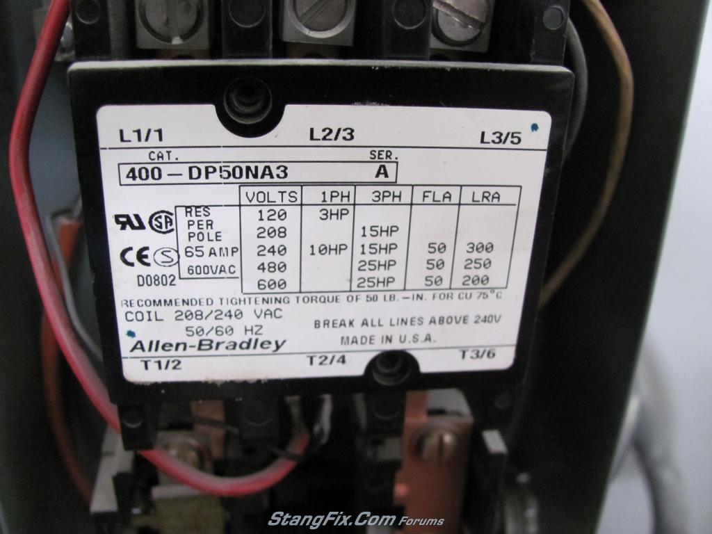

You say you have 120V at the coil but coils come in different voltage configurations. Is that a 240V coil by chance?
It is a 240v coil. The Contactor/coil assembly is an Allen-Bradley 400-DP50NA3 and was purchased new in Dec 2007.
As per the diagram, the L1 of the incoming feed provides 120v to the C1 coil leg (once it makes it through the pressure switch and low oil switch). The L2 of the incoming feed provides the other 120v to the C2 leg of the coil. The "X" and "Y" in the diagram is the Overload Relay block. I'm assuming that the two posts of the coil with each having 120v constitutes a 240v coil?

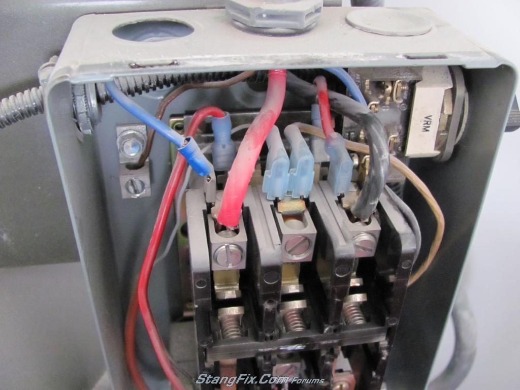

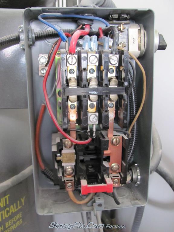

Picture of the contactor cover:
Overall:
Zoomed in upper
Zoomed in lower:
Tan and black wire is from the pressure switch, and the small gauge black and white wires from the convoluted tubing is from the low oil level switch (LOLS). The wiring diagram shows an auxiliary contactor, but the L2/T2 was used instead since an Allen Bradley contactor was used instead of the Square D one.
How its wired up: Blue wire from L1 goes to the On/Off switch in upper right corner of pic. From switch, black wire goes to pressure switch and back through tan wire to the center L post (L2 if you go by the cover), from that shared post it goes through white wire to the LOLS and then back to the bottom center post (T2 from the cover), then from that shared post the red wire goes to C1 of the coil.
For the other leg of the coil, there is a direct wire from the L3 post to the C2 post of the coil. It appears the Overload Relay block was bypassed when I wired it, and can't recall the reason I was told this. Maybe due to already having a heater?
Hope this clarifies what I have and if you can, let me know what you think the issue is. I have 120V at posts L1, L2, L3, T2, C1, and C2. From what I know, this means that everything is working up to the coil (no broken circuits).
