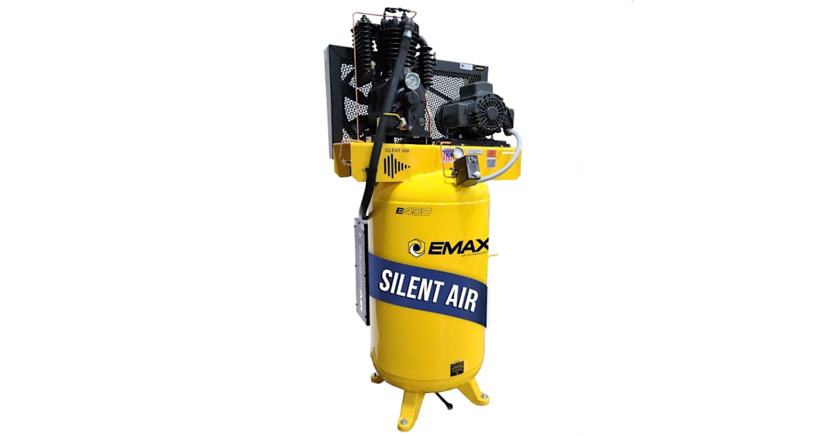

Out of those I'd choose the saylor beal every time.
I just purchased a 10HP Emax early this spring. It's a beast at 38cfm and it runs unbelievably quiet compared to the old C'aire 5HP that it replaced. It's also available with their silent air option but I didn't get that and don't know how much more difference it would make. I'm still amazed how quiet it is every time it cycles.
The old compressor is also two stage but has the higher speed 3450 motor on it and it is considerably louder. The Emax has 1750 rpm motor and disc valves in the four cylinder compressor. I'd been looking at a quincy locally and considered ordering a saylor-beal, but had also looked at this Emax several times. I was about to buy the quincy locally when I stumbled on the Emax at Home Depot onine. It was something like 25% off at that time, came out to only $2250 with free shipping and I jumped on it. Took about 6 weeks to be delivered via freight truck.

Great to hear a good review of the EMAX. This was one of the units I was looking at initially. I will keep an eye on HD website for discounts.
I have their full package 10hp VFD v4 model. I love it. very quiet, and it'll run down to half speed (even quieter!) instead of cycling on/off. I have it set to hold 90PSI because I don't need anything higher.
this one:
I've got over 2500 hours on it so far.
this one:
Hmm it seems the polar air compressors are cheaper than emax? I thought they were the same thing.
same thing. I called eaton compressor, I got a blue one. it's what they had available, and I needed it ASAP.
but make sure you're comparing apples to apples. eaton's list price won't include shipping, home depot's MIGHT (to store anyways).
