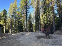

Disclaimer: I take full responsibility for my current situation and the contractor did exactly what I was asking him to do.
After a few rough winters here in the Sierras and no garage on the property my wife and I are finally pulling the trigger on a 30x40x12 metal frame shop. It's being built to our snow load spec of 80psf and will have studs/trusses 24" OC to accommodate the loads. For the foundation, the plan was to first do a 8"x16" footer below frost depth of 18" and have a 24" stem wall on the perimeter, 6" above grade, with the exception of 18"/grade level at the doors. I was hoping to get this part done in the next month so the building could be constructed on a foundation when it's delivered end of October. The building will be delivered with the frame and roof and our plan is to mill up the siding and frame in the ends with vehicle/man doors next year and tie in a slab as well. My understanding is that this foundation type is typical in our area.
The shop will be in a flat area behind our house in a zone where I've had to drop a number of small and large pines to make room. I hired a local (and recommended) excavator to come out and handle the earth work. My very naive instructions were that we needed the stumps removed and a building pad leveled and graded for a shop. I also explained that because of this was for a foundation the stumps had to be completely dug out and not just ground down below grade. Using a medium sized tractor/backhoe they made pretty quick work of some of the smaller stumps but there were a few larger ones where they dug down about 24" and then cut the taproot below the root ball. There's also a 28" stump that's still standing as of now due to a massive taproot. It's one of the trees I cut down just a few weeks ago and is pretty fresh.
So here's where things have gone off the rails. After talking more with a neighbor, I realized I was woefully unaware of compaction requirements with organic material removal. I also did not think to have that conversation with the contractor to gauge his level of understanding of earth work specifically for foundation requirements. After removing each stump, they backfilled the holes with the surrounding dirt and graded over it. No base gravel, no compaction layers, nothing. I now have a nice looking pad with no way to tell where stumps were previously and what dirt is original or filled. I don't know if this is a big problem for the footers as those would be at a total depth of at least 24" and there were no stumps in their path. But in terms of a future slab, my understanding is that the whole area is now compromised.
  1. What are our options at this point?
  2. How much dirt will have to be excavated and replaced now that fill dirt has been introduced?
  3. How much of a problem are we looking at if part of a tap root still exists below 24"?
  4. I'm thinking we'll need to delay delivery of our building to Spring and gut it out one more winter. Even if we can do the footers now, I'm guessing it would be horrendous to then have to try and remove large quantities of material inside the perimeter at a later time?
Again, this is my fault. My wife had a talk with me recently about finding more help as I've been doing significant amounts of tree work/snow removal/road maintenance on our property by myself the last few years and it's getting tiring. So I thought I was doing the right thing by hiring some professionals to at least handle most of the prep work, but unfortunately I didn't know the right questions to ask them. We also live in a rural area and finding the right people to ask is surprisingly difficult out here. On the bright side I'm glad we at least caught this now instead of later. And I got rid of another clump of trees in close proximity without nailing the house, so there's always that at least...
Edit: Originally we were not going the permitted route as we have an ag exception in our zoning laws. But since we're already planning on having everything engineered and will be building to code regardless, we might as well (and maybe avoid these kinds of situations).

Civil/geotechnical engineer and soils report is what you need. They will invasive test and recommend a compaction/grading solution for the specific foundation you will be using.
Here in NorCal, they are required for most new home foundations.

Are you saying that you're confident in the soils under the footings but worried about the interior slab subgrade?
Correct, at least with my original plan using the frost wall. The footing would actually be 12” by 18”, plus the 18” frost line would I believe would put everything down at 30”. I am “pretty confident” that we didn’t go below this line and also didn’t disturb any significant amount of soil in the area of the footings, just the interior slab area as you were inquiring. But I wouldn’t want to stake a building or possible foundation issue on that.
The primary concrete contractor in the area was out yesterday and didn’t seem concerned about the work that had been done so far. He also pointed out that we could simplify things and go the mono slab route. I did not realize this was an option in snow country with frost but after researching this forum I can understand the idea a bit more given it’s a metal frame shop only with no second floor/residence. He also gave me the number of his own earth works guy that I’m waiting to hear back from and get more info about what he would typically do in this situation for site prep.
Plumas Country strangely does not have mention of soils report in the garage plans submission checklist. Just architectural drawings, setbacks, and fire safe requirements.

How much fill was placed to level the pad? Any photos you can share? An example: You may can scrape off 2 feet of material, roll out the subsoil, then proofroll with a loaded dump truck. Any movement indicates areas that need attention.
I don’t think a lot of fill has been placed to level, but hopefully the photos give some idea. Mostly
just back-fill in stump holes is what I was worried about. But good point that the dirt being push to the low side might have the same issue.
The stump by where my tractor is parked is the slightly high side and where the front of the building would be. Where you can see some dirt has been pushed to is a little lower and where the back of the building has been placed. The left side would be within 3-5 feet of the large tree/tree line still standing and the right side 24’ from the house (marked with stakes) and leaving room for a 12’ lean-to coming to 12’ from the house (also marked with stakes). The property line is about 25-30 feet past the tree-line. The house faces a view in the opposite direction so not worried about losing any view out the back, and it would actually be a bonus to create a visual barrier to the neighbors.
I do have some leeway forward/backward on placement. Right now the front of the building would be just behind the big stump still standing, moving forward would place it over it but would receive the amount of dirt having to come to the low side at the back to level.

I see a lot of organics in that soil.
Yep…
I am not trying (although I may be😎) a ****, but….
OP…you are going to spend tens of thousands on a great garage…why take a chance.
Lots of good advice and it still seems like you are set on winging it. A few hundred/grand to be sure. Guessing on foundation design/soils may not go so well. Good luck and post up picks as it goes…

Thanks for the advice and knowledge everyone! I was actually able to track down our one geotech in town. Very friendly guy, just fired off an email at his request with some photos for a consultation. Hopefully he can do a site visit soon, I’ll share whatever info he comes back with.

Regarding not knowing where the good soil is vs the made ground - it will be really obvious when you drag an excavator bucket through the ground what is original and what is fill.
