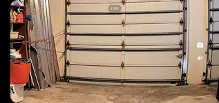

A few years back we bought a second home in a warm winter climate. The garage is a plain old 2 car attached type with an uncoated floor. In this warm climate it gets fairly hot in there in the summer and warm in the winter.
Last winter I noticed a white powder on the floor, didn't think much of it, swept it up and moved on. Recently when we went there, more powder and when cleaning it up it appears the concrete is turning to powder.
What is happening to this concrete, why is it happening and how do I stop it? Thanks in advance!

Based on where you are, this appears to be from deicing products dripping from your car. They are usually or always containing salts. If allowed to soak into the concrete, the water will evaporate, allowing the salts to again form crystals. When the crystals reform, they create pressure internal to the concrete, and the top of the slab is likely to spall off. What you are seeing is the salt which did not penetrate. Perhaps none penetrated due to a sealer previously installed.
You may want to consider installing a sealer on the slab.
There are threads here on concrete sealers, including boiled linseed oil. Myself, I am partial to the boiled linseed oil. It definitely has to be boiled, and applied correctly.

You indicated that this garage is in a warm winter climate, correct? if so, it's not probably not related to de-icing products, which generally result in spalling rather than dust.
Normally a slab that produces dust is exhibiting a condition know not surprisingly as 'dusting'. This results from excessive water in the surface layer during placement, which lowers the water cement ration and decreases concrete strength to a point that the surface abrades under normal use producing dust.
Your pics would suggest an extreme case and I'm not sure that's what your are experiencing. How old is the slab? Is there water present or some other condition that is causing the dust to collect?

To me, it looks like concrete efflorescence. Google it. "https://www.nitterhousemasonry.com/blog/what-is-efflorescence/
"Efflorescence is a crystalline deposit of salts that can form when water is present in or on brick, concrete, stone, stucco or other building surfaces. It has a white or greyish tint and consists of salt deposits that remain on the surface after water evaporates. In addition, efflorescence can appear as a powdery substance on floors and walls and requires special care to treat."

To provide some additional info and answer your questions above.
House is in South East Florida. Hot, humid environment 7 months a year. No concern of winter environment.
The house is not used much in the May - Oct period, so "fresh air" is introduced during that period.
It is built in 1994 by others, so I don't know and can't find out the history of the pour.
The "dust is definitely coming up out of the slab as I can see where the surface is pot marking at these points.
Another thing I just noticed based on LMG's comment, it the problem seems to be only happening in one of the 2 bays, the one where a vehicle is usually parked.
We have owned the house for a number of years, and don't remember seeing this, or at least it was not as big of an issue as it is now.

Here is a pic of both sides. The left - in the camera view which is actually right garage bay has no dusting issue. As you can also see, this was not installed well and has no expansion joint, so it made its own.
Another thought I had after it was mentioned above, is the previous owner was a fisherman and when we were looking at the house his boat sitting on its trailer was parked in the bay with the issues. Maybe he was lazy a few times or few dozen times and put the boat in the garage right after it came out of the salt water without washing it off and letting it dry. The community we are in has a boat ramp about 50' from our house.
But again, this problem did not exist when we bought the house. Maybe the salt impregnated in the floor was reactivated by me pulling in a wet hot truck or by leaving the doors closed for months at a time in the FL summer.
In any case, anyone have an idea how I can arrest the deterioration now? Long term plan (sometime next year) would be to gut the garage, redo the floor and install new cabinets - all the existing are used stuff he pulled out of peoples houses.
Thanks again for your time and input.
Here are closeups of the worst areas.

@GlennSullivan , You mention being 50' from a ramp. Is it salt water? With the right conditions, there is a lot of salt in the air. Is it possible that the vehicles are bringing in more salt with light rains?
It may be helpful to at least confirm or rule out salt. How about testing the powder with one of those salt water pool test kits?
BTW, is the first picture in post #11 looks like the door thresholds are well below your pad. Am I seeing it correctly? It would be an odd configuration. I'm wondering if there is a reason?

Excellent idea of taking some of the powder, mixing with fresh water and using the pool test kit to do a saline test. This will tell a lot!!
Yes, the boat ramp is on a salt water creek, leading to a section of Loxahatchee River which empties into the Atlantic. Total distance from ramp to ocean inlet by water is approx 3.5 miles. I do not have a boat so my vehicles do not use the ramp and I don't drive past it, however, neighbors that use must drive by my house so their vehicles, trailers and boats can be leaving salt water on the road in front of my house. Not sure how much accumulates as the ramp is not heavily used and it rains alot in south Florida. The road is pitched toward the ramp, so rain will wash the road into the ramp.
The garage door thresholds have about a 1.25" 1.5" step in them which transitions the driveway to the garage door floor. The doors close onto the outer / lower section and provide a good / tight water and animal seal, I wish I had this in my big garage.
What are you doing or did you do to resolve your problem.
I have a disk style surface washer attachment that I can use to do the garage floor without getting the entire garage and everything in it soaked. Will prolly do that as a first step, unless someone can suggest a chemical that can be rolled or squeegeed on and washed off that will treat it better.

I mentioned the proximity to salt water because of how much is in the air near water. Machinery etc. rust faster and you can feel the film on items sitting in the salt air. You may be seeing some wash down off vehicles with light rain. That could be adding to whatever came off the previous owners boat?
High concentration salt buildup does some goofy stuff. Throw softener salt crystals on a concrete floor in high humidity. Drops will form around the salt. I keep some partial bags in plastic pails during the summer. It's common to have quite a bit of liquid brine in the pail during high humidity. Your floor may even be doing cycles of condensation - drying and creating crystals during the drying process. If you have salt concentration, the floor may feel slimy when it's wet.
Maybe you are lucky and it is just salt built up over the years. It may be a lot and well into the concrete.
In my case, it was a only few years worth of salt buildup. I vacuumed the pad and did a few scrubbing rounds. I used a shop vac to **** up the last bit of moisture and anything else each round. I let it dry completely in between scrubbing rounds to verify there was no residue coming up. I honestly thought it was good after the second round until it dried completely. I still had some crystals so I kept going.
I may have been over diligent but my long term plan was to use a good sealer. I didn't want to seal anything into the concrete.
In the end, I found a guy that did coatings as a side gig. His main job was resurfacing parking ramps in our climate. I figured his advice was worth a shot.
I ended up with a heavy grind on the entire pad and top coated using a high solid epoxy and al. oxide for abrasion. I'm not a huge fan of the top coat, but it is fantastic at preventing salt and slop from seeping through. I'm a big fan of that aspect. I'm able to rinse the floor during the season and do not see residual crystal formation.

**UPDATE**
Finally got back to this house and we vacuumed and then pressure washed the entire garage floor, vacuuming up any residual water when done. No vehicles have been in the garage since the cleaning.
48 Hours later the pictures below are what we saw. this is not powder, but very light fibrous material - like cotton candy, but lighter and not sticky. Any thoughts of what this is, considering the additional information?

Well, after doing some research, it appears this is, in fact effloresce as some of you indicated above. It does appear to not be as widespread after the pressure washing with the surface washer yesterday.
In searching this subject on search engines, there are dozens of different approaches to tackling / resolving this, what say you guys?

It’s efflorescence caused by water in the concrete leaving deposits on the surface as it pushes up and dries. That’s as bad as I’ve seen it and I’m a GC. My experience is that any film product just disintegrates as it has nothing to stick to. It’s not from vehicle salt as that degrades the surface and dusts. Something is pushing water through that slab.

My experience for residential that It happened primarily on substandard or damaged concrete on a floor slab. It would come through a patched trench that had been cut for utility repair and repoured, while the surrounding existing concrete was okay. Walls are a different story. It seems like the PSI of the poured concrete has an effect as someone once told me 4000 and above was immune. That was only hearsay so I can't stand behind it but it seems logical.
Someone who knows more than I do about coatings may have a better idea than I do. I would wet mop it , vacuum and stiff brush, and try one of the products that sinks in and supposedly waterproofs the concrete. They' I've used it on brick work etc, but never on a slab. Might be worth a shot. Xypex is one product. I have never had this happen on any concrete that I poured so it was always an existing problem and the options were replace or live with it.

I would guess that water dripping off your cars is drawing efflorescence to the surface. (Mostly calcium hydroxide. Test it with some vinegar)
It is happening because your concrete did not have a pozzolan in the mix, and had high water/cement ratio.
It is too late for some fly ash or slag, but the silicate densifiers will react with the Ca(OH)2 near the surface. See post #12 above.
