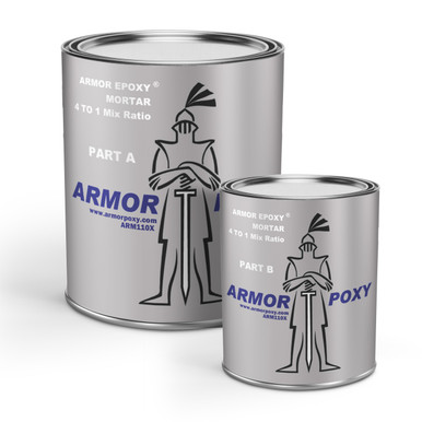

Hi, you could use our Epoxy Mortar for this. Stronger than concrete, easy to apply and grind smooth and has a 'natural' look to it and uses a clear resin binder.

I see it comes in different colors. Does the natural concrete have a mixture of the light and dark gray with it? I was thinking of mixing a separate batch of each and kinda blending them over the large areas.

They all use a sand colored aggregate, the colors have pigmented resin which gives the color So the natural has mor of a beige sand color.
