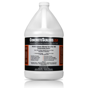

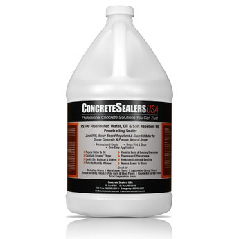

I'm looking at using a penetrating sealer for my shop floor, I just wanted to hear some feedback from anyone who's gone down this path and how it worked out for you so far.
Any tips or tricks you learned during the application? Have you had to touch it up or re-apply at all, what happened that broke through the protection? Wondering how the resistance is to things like brake cleaner, can't seem to find a straight answer on that.
I have a new machine-troweled slab (6 months old) in a shop I plan on using for automotive hobby work, main concern is protecting the floor from stains. Going with a sealer instead of a topical coating seems to be the best bet for me, I do plan on doing metal work and dragging things across the concrete.
I'm currently looking at the Concrete Sealers PS100 and trying to work out what all the steps are. May consider laying down their PS103 Densifier first.

The PS103 and PS100 combo provides excellent protection. Applying the PS103 will make the surface harder, which is what you want if you are dragging metal and other objects across the surface. It will also allow the PS100 to work even better since less sealer is absorbed by the concrete due to it being more dense.
Something you need to understand is that penetrating sealers and densifiers are non-film-forming. This means that water, liquids, and oil can get through at some point. The job of these products is to provide enough time for proper cleanup of a spill. There is no guarantee that you won't get the occasional stain, but it will be far less than what you would expect from a densifier treatment alone. Brake Cleaner usually won't have much of an effect since it evaporates so quickly.
I'm not sure what the first responder (DeChev) is referring to regarding "Super" densifiers. PS100 is not a densifier. It's an oleophobic penetrating sealer. It incorporates fluoronated material to repel oil, water, and salt. Standard penetrating sealers will not repel oil.

I recently did the PS103 PS100 combo on a new shop. It's been down about a month. I can pour cutting oil on the floor and it beads up. You can wipe it right up. But I haven't done a long term test, I should do it in a spot I'm going to cover.

How much time you are allowed before cleaning a mess is dependent upon many factors. The finish and initial porosity of the concrete surface, whether or not enough sealer was applied initially (some people stretch applications to save money), the type of spill, etc. It's a good question, but one that can't be answered properly due to all the variables. The testing performed in our article was over a 24-hour period.
If a liquid known to stain concrete sits for more than a day or two, chances are you will have some sort of residual stain remaining once it is cleaned. Some people have reported spills sitting longer without issue, while others with more porous concrete reported stains occurring when sitting for a shorter time than that.

I see that there are some comments insinuating that my application, or surface might be "less than optimal". I applied sealer till rejection. Meaning that I still have white stains where the sealer created a barrier to more sealer penetrating. My slab is very smooth power troweled. It just does not get better than my contractors did.
At first water, oil, anything beaded. It is almost 3 years old now and water does not bead and if an oil drop sits overnight, BAM! permanent stain.
