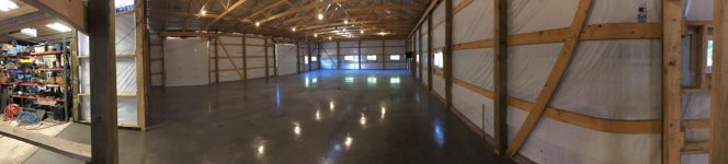

OK, the only thing I don't understan is that it seems to me it would be easier than following visually a chalkline... to set the mud girt boards level w a laser or Builders level, THEN screw some extension ears on the screed board in the correct place so the ears would ride on the top of the mudboard.. no matter how that elevation is different than the slab surface.
I would just think less room for error riding on a finite surface rather than eyeballing to a chalkline... less chance of uneven finished floor.
But I guess if the Finishers are skilled, AND used to be able to do that, all that matters is the finished product.
Marc

It's always nice to set forms to grade - it's just not usually necessary. Most crews can wet screed a very flat floor. Probably best to talk to your finisher about what they need. There are many possible methods - some obviously better than others.
I'm not a fan of using chalk lines. It's too easy to lose them when concrete splashes against the form. A laser provides a consistent reference over the entire area wherever it's needed.
Keep in mind that striking off the concrete is just the first of several steps that determine flatness. Bull floating followed by several operations with float blades will further level the concrete after screeding. As long as the floor is screeded reasonably well, it is these subsequent operations that will determine flatness.

I set the line for the slab height. The crew used a power screed and a laser level and a pole taking measurements periodically to make sure they were correct.
