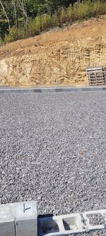

Hey all,
longtime lurker here but making my first post.
I am in the process of building a detached garage, 40' ft wide and 30' deep. The footers and block foundation are complete. I am in the East Tennessee area so we do get some freeze and thaw.
My next step is getting the slab poured. Before I start contacting concrete contractors, I wanted to get some opinion. Right now, I am planning plastic sheeting moisture barrier over gravel base, 4" slab using 4000 psi fiber reinforced concrete. My main question is whether or not I need rebar also.
My friend poured a similar size slab approximately 2 years ago with no rebar and it has held up fine so far.
The garage will mainly be used for working on my jeep and other vehicles. All vehicles are normal passenger vehicles with the heaviest being a 1/2 ton truck. I will also be parking my boat in the garage. The combined weight of the boat and trailer is approximately 6500 lbs. I do plan to install a 2 post lift in the future. The areas where the lift posts will be mounted, I will dig out a 3' X 3' area to make the concrete 6" to 8" thick.
For those with concrete knowledge, what advice do you have for my situation?
Thanks!

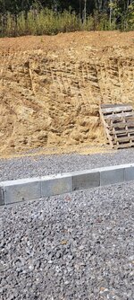

Thanks for all the replies and info. I will keep this in mind as I talk to the concrete folks and come up with a final plan.
My base is solid, virgin ground on a hard shale. When I was using rebar as grade stakes for the foundation, the ground is so hard I has to drill with a masonry bit to get the stakes in. You can see in the background in the attached pics what's been excavated to get the land ready to build the garage.20230924_141447.jpg20230924_141500.jpg
