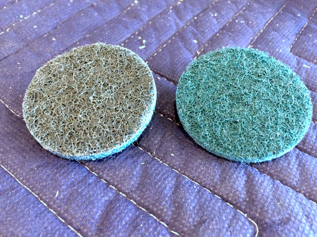

First off, I'm honestly not even sure what these are actually called, I've seen them referred to by a million different names. Feel free to let me know haha.
Anyways, I'm looking for these style discs, but for angle grinder. I know theres sandpaper discs and such but I don't want something that aggressive.

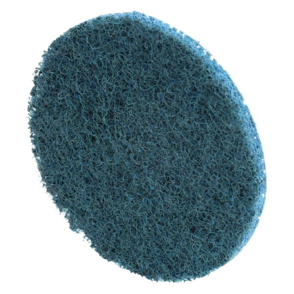

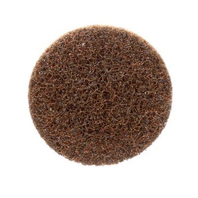

They are Scotchbrite discs the coarsest one is brown, the medium one is red and the lightest abrasive action is blue. The generic name for these is surface conditioning discs or non-woven discs. They typically have a Roloc button on the back that attaches to the right angle die grinder pad they are normally used with.

Good info, thank you!
