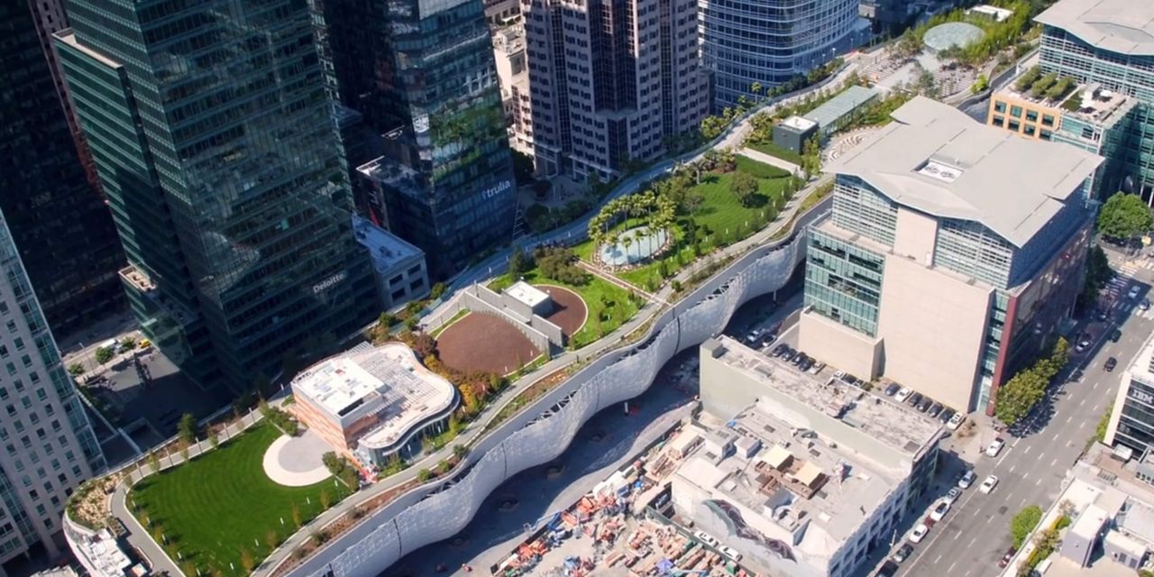

My brother has been involved at a high level with membrane roofing for about 40 years. They do everything from military installations to sports stadiums, college campuses, software campuses like Google etc., high rise complexes in it. They even hide underground buildings using it with landscape over it in harsh climates. It is expensive because of the prep and materials. All the seams are heat welded. Button caps hold it on to avoid perforations thru the membrane. It comes in PVC (Sarnafil) and EPDM rubber etc.. Most home owners would not be interested in it because of the cost.
example of a complex Sarnafil roof. The Salesforce complex in San Francisco https://sika.scene7.com/is/image/sika/usa-salesforce-transbay-transit-center-san-francisco?wid=1280
