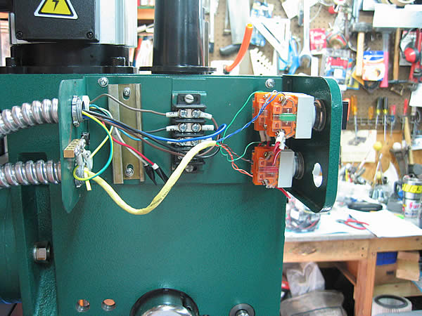

Because the VFD has to drive the motor directly and not through the machine controls. The VFD has to have it's inputs programmed for the required contact closures (e-stop, reverse, etc) then you wire the machine controls into those contact inputs. You can't just feed 3 phase into the machine's plug. The control box on my Grizzly was full of wires and contactors. When I got done, there was nothing left but the buttons and switches.
Left side of box is the motor leads, right side is twisted pair cable from the machine controls.
Gutted control box:
I'd run this on every machine if I could afford the change out. Turn off the drill press and it spins down slow. Turn off the lathe and it spins to a stop in a little bit. Hit the E-stop on the mill and the spindle stops in .3 seconds. Normal braking stop is 2 seconds. I can also vary the frequency fed to the motor, so I can move the 6 standard mill speeds about 20% faster or slower. I also have the instant reverse, but I just don't use it. If I get a tapping head, I may wire that up.

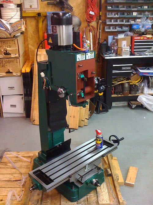

Is the Grizzly a lathe or mill? More pics?:D How do you like it?
It's a G0519 square column mill/drill. It's a decent piece with a few issues. The Z feed on the spindle loses about .005 every 4-6 turns. The exterior down feed parts were replaced but the new ones did the same. I suspect a burr in the gears on the spindle but haven't taken it that far apart. I use a digital scale on the Z anyway. It's fairly hard to tram as you have to fiddle with shims and bolt torque on the tower bolts changes the tram. It's pretty solid (about 800 lbs) and more than accurate enough for me. It's certainly not a knee mill or Bridgeport, but it was the most I could afford. Based on the cost of a race C4 like one from PA, doing certain mods here with the machine basically paid for the machine in the first year. After the move, it's level but the base looks like it needs some shimming and it'll have to be re-trammed. I built my own base for it because the optional base is sized for tiny China guy and I'm 6' 1'. I also added a power feed to it - handy.
