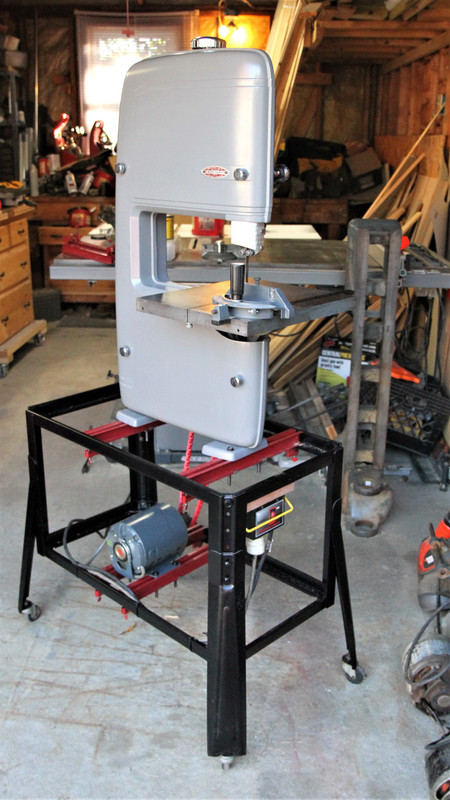

I have a few of these band saws here. Well, 3 and some parts. I picked up 4 of them for next to nothing. I don't think I have $120 in the lot of them. I set one up as a wood only saw.
I have a 2nd saw that I am going to set up similar to the link above with a jack shaft and pulleys. Just need to finish the switch, mount the motor and mount the pillow blocks. Still need to decide on some pulleys and get them.
My thinking on these saws isn't to replace a good horizontal saw, it is an inexpensive solution to a metal cutting saw for occasional use. I batted the idea around of picking up a deep cut or similar from any of the current offerings or do the jack shaft on one of these saws. I expect it is probably a wash. Anybody know for sure? If it doesn't work, at least adequate, I'll take the pulley assembly off and use it with a wood coping blade and maybe keep a resaw blade or GP blade on the pictured one. After looking at the youtube video above, that would be acceptable performance for my needs. OP, does that seem adequate or less than acceptable?
Either way, I am on the look out for a small horizontal saw as a project. Just missed one a few weeks ago.
My use is occasional DIY.
OP, good luck with your decision.
