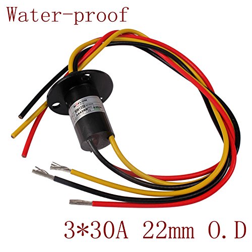

What about the slip ring. How do you recreate that?
I have not taken the hose reel apart so I don’t know what the slip ring is. Is it an air tight pivot?
That be be the undoing of this plan. I might have to make that connection WiFi then.;)

The slip rings are what allows the reel to work. The reel has 3 rings and fingers that transmitt the power from the feed to the rotating part of the reel and then to the cord. Think old style brushes and commutator technology.

I think for this purpose, the comutator is not segmented, it is a solid ring.
I think it could be made or adapted / repurposed from something else.

Correct on the ring being solid. You could fab one up, but the question is, how much is your time worth and your safety? Reels can be had for under 300$, but how big of a load are you wanting to power and how far away? 10-15 amps at under 50, and units can be found fairly inexpensively. More than that and you are getting into heavy duty commercial gear with the need for significant dollars.

The slip ring has to carry the current properly. This is the weak point on the smaller non-commercial cord reels, along with low amperage ratings.. I have seen several where the slip rings fail while the person was trying to run a table saw or other higher draw tool on them. The slip ring drags are often mounted in a thermoplastic mount which becomes hot enough to melt, causing the unit to fail. I finally found a commercial unit for myself and absolutely love using it.

Slip rings are available on Amazon for less than $20 - non UL and made in China - but would probably work fine:
https://smile.amazon.com/Wires-Generator-250Rpm-Power-Collector/dp/B00MYYTWQ8?sa-no-redirect=1
Still a lot of work for what you want.
