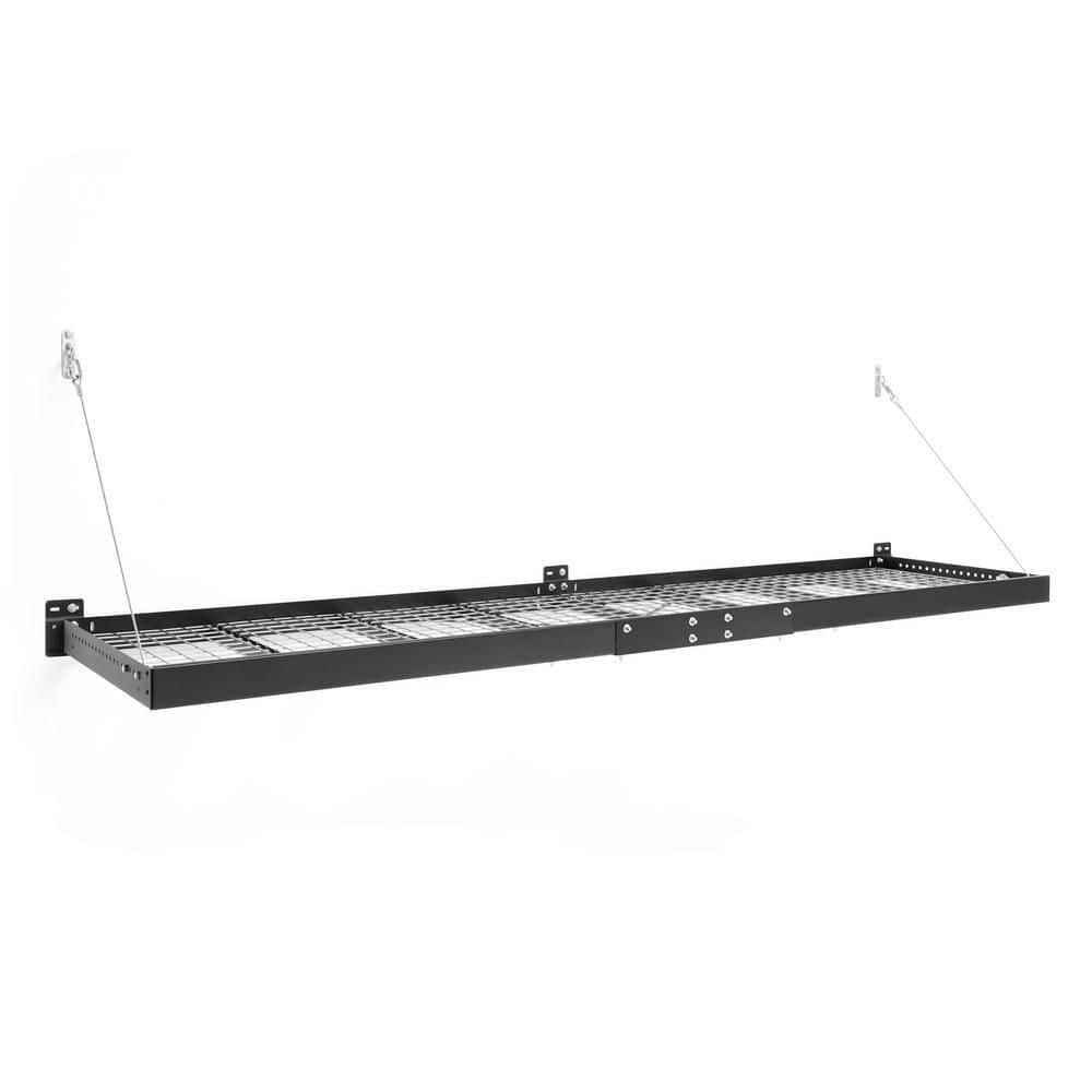

Being kind of cheap and needing wall mounted shelving I had an idea the other day. Here is a pretty standard steel rack style of shelving that gives me 4x 6 foot "shelves" for $200.
Here is a wall mounted version using cables that is $300 for an 8 foot shelf.
Has anyone put up the cable hung style before? Could I just buy some eyelets and stainless cable, and do the same thing using the shelves of the cheaper rack?

Not if you plan to hang multiple shelves from the same cable. The biggest problem with hanging (anything) from the ceiling is that most modern ceilings are only designed to handle the weight of insulation, drywall and paint - nothing more. There are volumes written on the site about this, so I won't repeat those points here.
Companies can offer the shelf like you posted with minimal risk because a single, light duty, narrow shelf hanging from the ceiling (tied to the ceiling close to a wall) probably isn't going to cause a problem. When you expand the concept to heavy duty (and heavy weight) shelves and multiply the number of shelves hanging from the ceiling, you get into structural issues.

thanks but I was planning on hanging the shelving with cables to the wall not the ceiling, my garage wall is framed with 2x6's so I think it should be ok?

won't work with the one you have linked. each shelf consists of 5 pieces (4 supports and one deck). You would need to weld everything together first. even then, it would probably be flimsy without the support of the uprights it's designed to work with.
