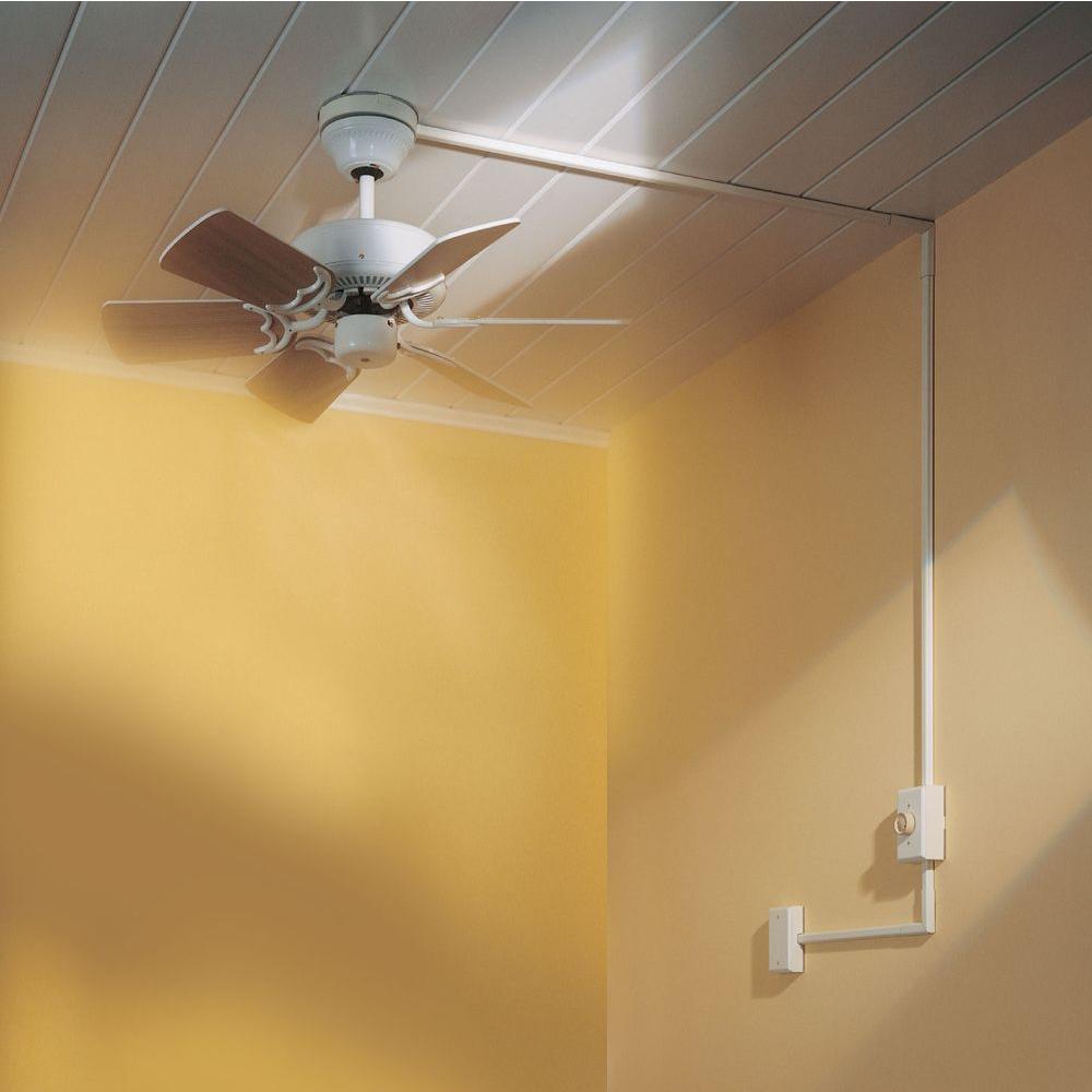

Thinking outside the (round ceiling) box here - what about installing a wiremold round extension onto the existing round box, and run a section of wiremold to a surface-mounted receptacle box? You can put the receptacle box right next to the round box if you want, or put it wherever.
https://www.homedepot.com/p/Legrand-Wiremold-500-and-700-Series-Metal-Surface-Raceway-5-1-2-in-Open-Base-Extension-Box-Ivory-V5737A/202276743
Picture this:
but instead of a ceiling fan hanging from it, there's just a blank round cover, and instead of the wiremold running down to the switch on the wall, it runs to a receptacle box mounted either on the ceiling right next to the round box, or wherever else you want it.
