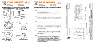

I have had this hammer for a long time, and it wasn’t new when I got it. The faces are done for. Am I right that they are pressed in, and I will probably have to drill them out? As near as I can tell, they are 1 1/2 inch diameter. If I buy 1 1/2 and they are too big I can turn them down. Any suggestions for sources? I already checked McMaster Carr, about twelve bucks apiece, plus shipping. I will probably just go with that IMG_4573.jpeg

A hammer with replaceable plastic faces can give surfaces with identical hardness. They are far more versatile as you can have a very soft or very hard face on the other side. You can even get them in dead blow.

The ones I’m familiar with would have a solid copper or bronze head. Is the center of the head magnetic? If so, then the tips could be pressed in or even threaded.

Are you sure this is a hammer with replaceable faces?
It looks to me like a copper hammer that has a solid copper head, rather than a replaceable face hammer, with a cast iron head and replaceable faces, like a Garland or Thor model, although it’s hard to tell from the pic.
Even if it is a version with faces made to be replaced, it looks like the central core might have been used long enough that the central head has gotten deformed outward.
