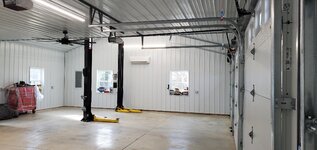

Just had a garage/shop built and the builder talked me into doing the interior with white corragated stainless steel , never have to paint , washable , etc. Problem is how do you hang anything? Flags, pictures, and ofcourse wall hanging shelves. Been doing all kinds of research . There are different shapes. Have found no ideas. Any help out there?? Thank you.

It's a bit tricky but I'd just use pop rivets wherever I'd need them.
If you ever move something and want to remove the hole, it's a bit more tricky but can be done too (could even just leave a rivet inside and wouldn't look bad, or weld it up, grind it flat and spray paint it white).
You can make simple hangers like this:
A rivet in each corner and it'll carry a lot. A nice and strong solution to welding a screw on sheet metal is to use these screws:
Drill through the plate, then drill the right chamfer for the head, stick the screw through and weld it around the head only, then grind flat. It's not going anywhere like this no matter how hard you tighten it, and the outer side will be totally seamless...

What kind of framing are you working with? Is this a pole barn or stick framed building? For heavier stuff like wall shelves take a look at the different shelving tracks and supports at your local building supply. Since you know where the interior purlins/straps are by finding the screws in the panels mounting should be a snap. If you plan on storing your vintage vise collection, hitting posts or studs would be preferable. Something like this from the borg has would work, and the ribs would not interfere much with the shelves like they would with other systems or cabinet types.
I’d consider Rivnuts for smaller stuff, like flags and other small things. The zip tie adhesive blocks also work well if you clean the metal before install.

Signs, flags and pictures don't take a lot of strength. Wall anchors are OK. Many shelf brackets will work fine. You may want to notch shelves around the ribs to avoid the gap. Spacers and unistrut can come in handy.

I'd use freestanding shelves and utilize the existing screws for your decorations. There's wood behind each screw.
This isn't drywall and there's no patching holes. The metal is not going to support anything beyond decorations and maybe a clock.
Do you know how they built your interior wall? They either sheathed the whole wall or just like the outside put on horizontal wall first to fasten the metal to.
There are some options for wood applied over the metal that I can describe if are interested.

For decorations (flags, posters, etc.) and other lightweight stuff, simply use strong (rare earth) magnets, with or without hooks. For heavy items do the same as you would with drywall -- find the structure behind the wall. Horizontal cleats can be screwed into the framing behind the steel. For big shelf units, stand on the ground.

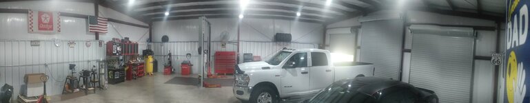

Congrats on the new shop! I have similar walls. I use toggle bolts for the heavy stuff (Cabinets etc.) but I also made sure that the bolts went thru the steel frame that the sheets are connected too. For the signs/lighter stuff, I use the self tapping bolts that they erect the building with. They left us thousands of bolts in unopened bags.
