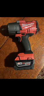

I got a
Metabo 1/2” impact from a member here.​
Seems well made. NIB. With 2 batteries and charger for $200. I was thinking of a slightly cheaper HF unit. But I think I got a much better tool for slightly more $$.
