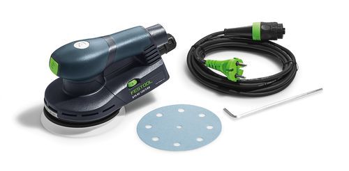

Looking to get a die grinder, a cut off tool, orbital sander etc. so should I go for the pneumatic or cordless models?
Opinions will vary, but I absolutely hate using a pneumatic sander. You have a big stiff air hose that hinders maneuverability and these things are huge air hogs. My little 5" Sioux DA consumes >15 CFM which runs my noisy 5 HP compressor continuously. So compared to a simple corded electric sander, it's less ergonomic to use, requires >5 HP to run and is deafening. (all at high duty cycles). No thanks!!
I think there's a place for corded, cordless and pneumatic depending on the tool and task.
And I hate using electric sanders. Huge motor under my palm that I have to muscle around, and hardly enough power or speed. Plus electric sanders sit way higher, making my hand work harder at keeping it flat, and then there's the fact that electric sanders get warm, whereas air sanders get cooler as you use them
Yes, my 6" Dynabrade is an air hog. But my compressor is quiet enough (or to put it better, well placed so the noise isn't a bother), and has no trouble keeping up.
As for the hose, I have a swivel with a lightweight whip on my sanders that I tie to my vacuum hose. The dust collection is hose WAY more restrictive than any air hose.
