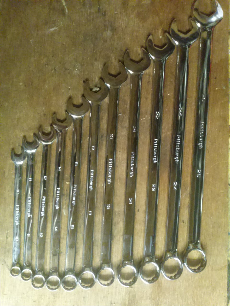

I am a harbor freight junkie, but I'm not wild about their wrenches:
I bought that set for $19, which is a steal, but the 24mm already has tool marks on the open end... from using it to hold a camshaft in place while setting valve time. Others have made the same remarks.
Not the strongest metal in the world, in other words.
On the other hand, the fit is excellent, the finish isn't bad, and the 10mm, 12mm, 14mm and 17mm long handles have been VERY useful, and haven't broken under a decent bit of strain, i.e. those notoriously sticky Honda oil drain plugs.
They have a wrench set with larger sizes, but the skips change; my 11-piece set has 21mm, 22mm, 24mm and 26mm, while the 14-piece set has 21mm, 22mm, 24mm, 27mm, 30mm and 32mm.
