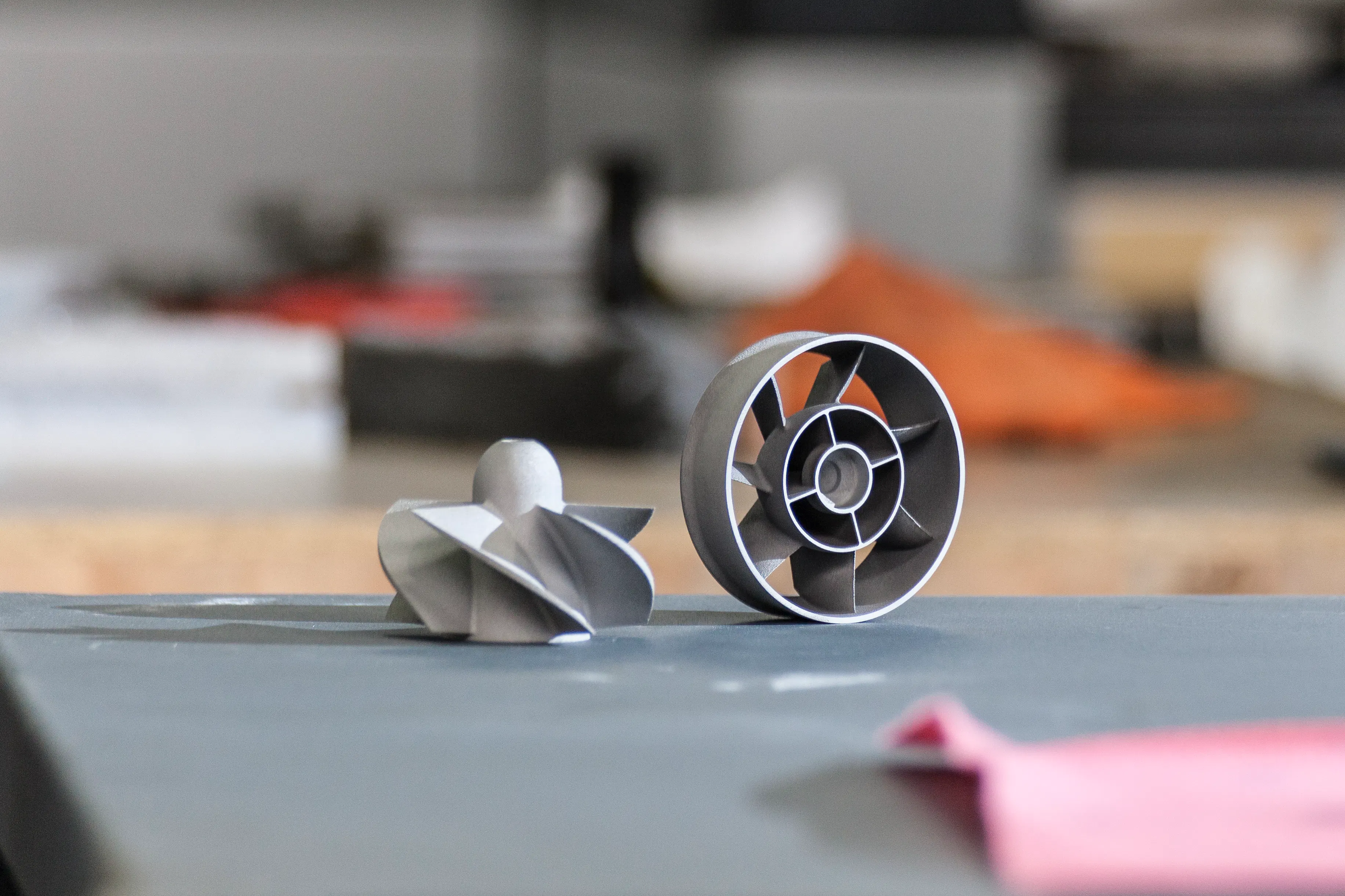

If youre okay with a cast reproduction wrench, it shouldn't be too hard to reproduce. Model the wrench in CAD, numbers and letters and all, minus the hex area. 3D print it, taking size into account for casting shrinkage. Then have it cast (I've used cattail foundry in the past) then drill and broach the hex area. If it is for light duty work it should be more then good enough.
mike93lx
Dec 9, 2013
37,961
Richmond, VA
Why go through all the cad and 3d printing when you could just use the existing wrench as a pattern?
formula388
Aug 18, 2011
62
West Islip, NY
lol very true. I have done the process so many times for parts I dont have, I didnt even think about having the part and needing to copy it. Whoops, youre right.

The boys at the local skunk works aero shop have a "additive manufacturing 3d printer" doing classified stuff.
After google here is an on line service:
You would also have the lettering then.
