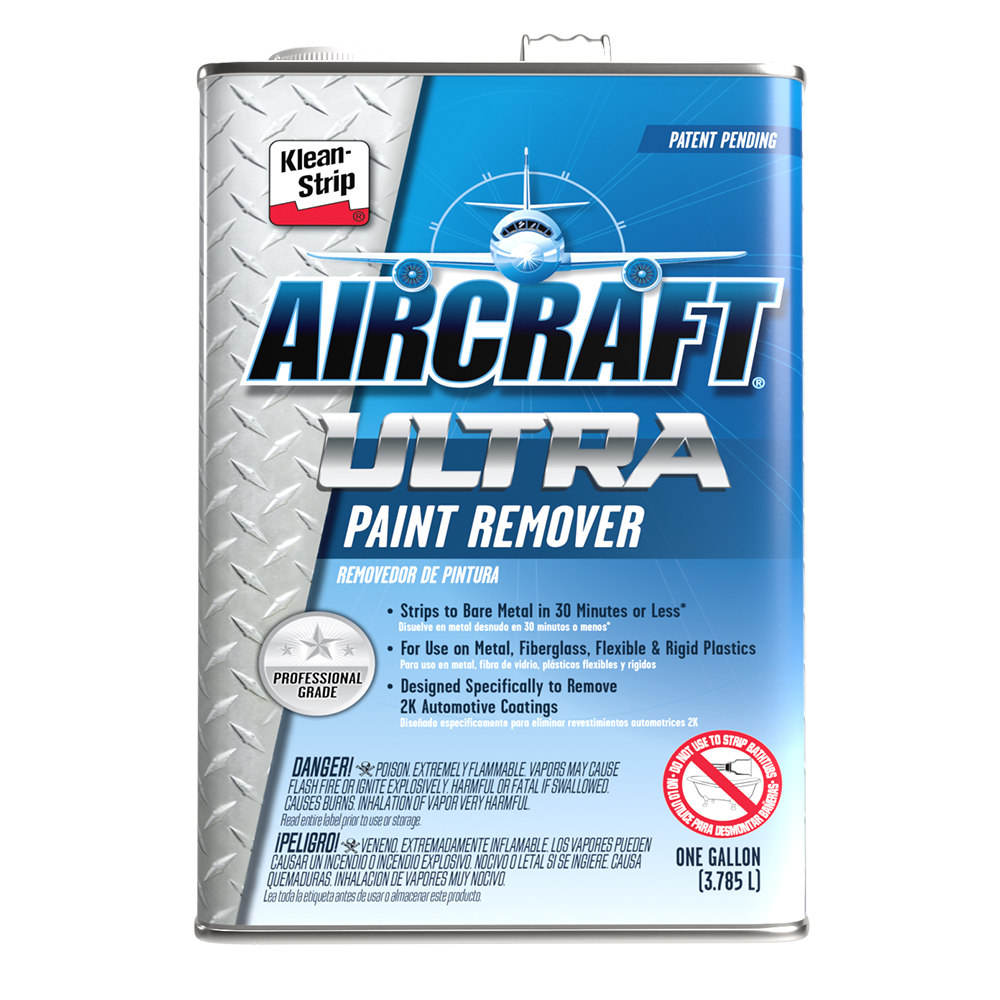

AKA aircraft remover. We used to joke this stuff actually “removes aircraft from the runway”. The new stuff is not as good as the older, I’m sure way more toxic variety. Put the box on a thick poly sheet outside. Apply. Should be good in about 30-45 minutes. Putty knife and a brass brush. Do not get on plastic/rubber.
