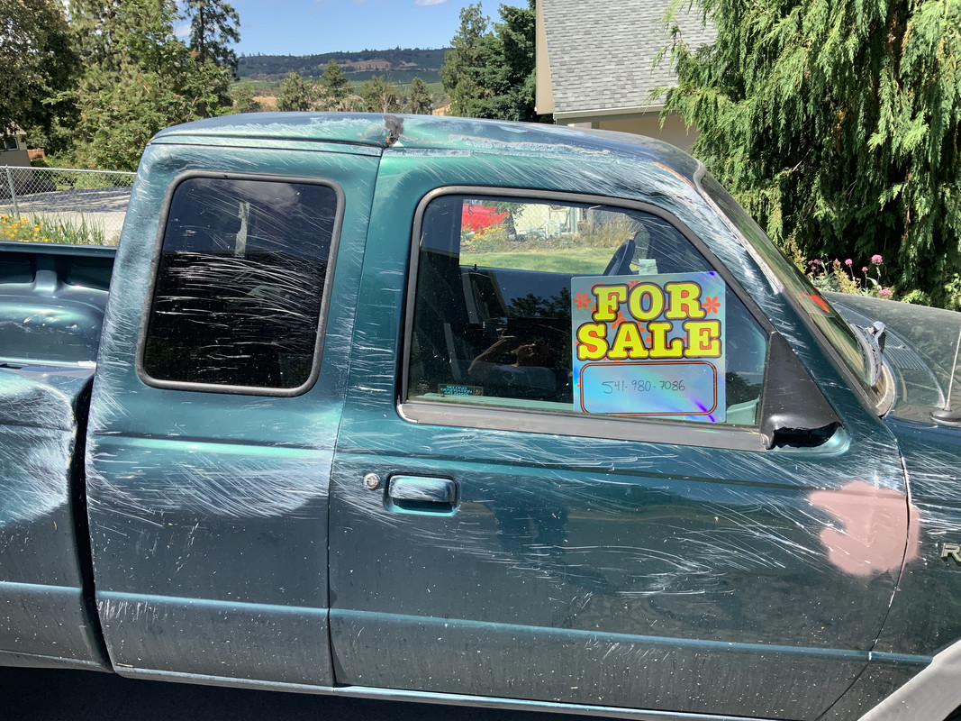

I would have attempted this a few years ago but I don’t have the tools or resources now. This is my neighbors truck, he wants $1,000 for it but I could probably get it for $500. I think it’s a 1999. 4.0, 4X4, auto, air, 150,000 miles. I could source a bed side, door and fender no problem but the cab is the real problem. Can it be fixed?

It's not worth fixing. Cheaper to replace. You'd be better off not buying it and buying one that isn't smashed up.

Yes, I’m slowly talking myself out of it.

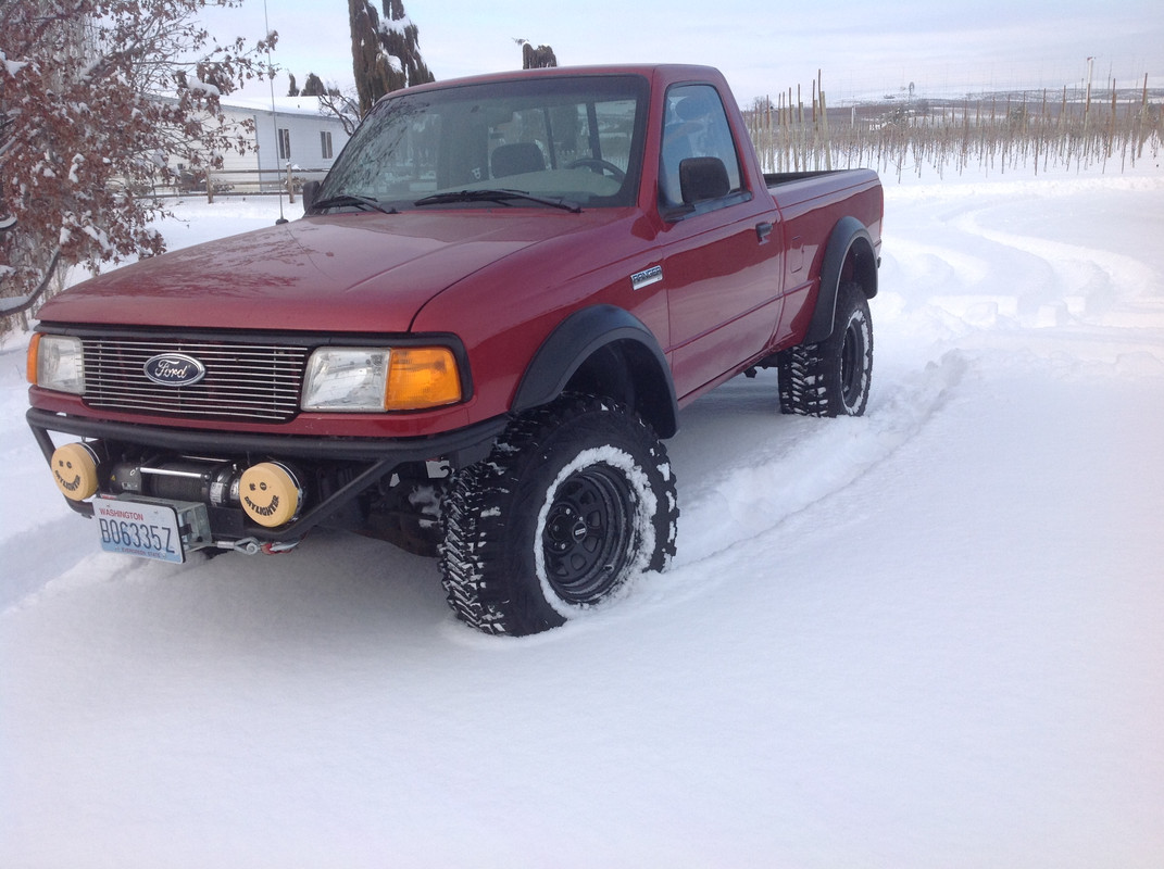

This is a truck project I did a few years ago. I bought a roll over (woman died in it) 1997 truck for $500. It had extremely low miles like 40,000. I bought another truck with a blown motor but a good body and put its body on the 4X4 frame. This was a tremendous amount of work but it was an awesome rig. I had $6,000 into it when I sold it but I got my money back (not including my labor of course).

Yes it can be fixed.
Spot puller and a ton of,time
Not sure it’s worth the effort verses the value

I’d fix that. Cost nothing but your time. Getting door squared up might be a challenge without a puller. Depends on how you expect end product. Driver or show and shine

Got any tech schools nearby ? Any bodyman worth a damn(tech schools teacher) can have that cab/door pretty straight and in primer in 2 days.It's not much work really.
Shoot it with a gallon of Rustoleum gray or white.Put a flatbed on the thing. Nice little utility truck for hauling motors, firewood,atc/bikes, sacks of rock and gardening **** so as not to mess up the yuppie rig.

If your set of fixing the existing cab, you could cut out all the damage and weld in a replacement from a donor cab. Personally id just get rid of the scratches on the glass and drive it until it dies for the price. With those miles youll probably be able to get at least a couple good years out of it.

It can be fixed, depends on how long you plan on keeping it and how much time you want to put in it.

Long as the suspension isn't borked - you might fix the body issues but if the rear end mounts or front end got whacked hard or the frame is tweaked you're going to be spending more on tires and front end parts than that thing is worth. If that all checks out, go for it, just realize you may be in for more than just dented sheet metal...

by no means a body expert, or even close ... but I did rebuild a 1982 Cutlass Supreme that had been sideswiped on the drivers side and ins wreck.Replaced the door, front fender, rear quarter & header panel. pulled the door post as it had been pushed back. Car was hit high as the bumpers weren't touched . it was a lot of work, and I came out with a decent car for not a lot of money .
To me, the roof on that would be the toughest repair and getting the doors to not leak may be a job... but that's just an uneducated opinion

If you just need the transportation, I'd probably go with an hour or two of hammering followed by rattle-canning the worst of the scratches (mostly for slowing down the inevitable rust), call it good.
As others have pointed out, not worth fixing if $ is the issue.
It just depends on what you want. I put probably $10x of my time and treasure into fixing a car worth $x, still have it and glad I did it.
