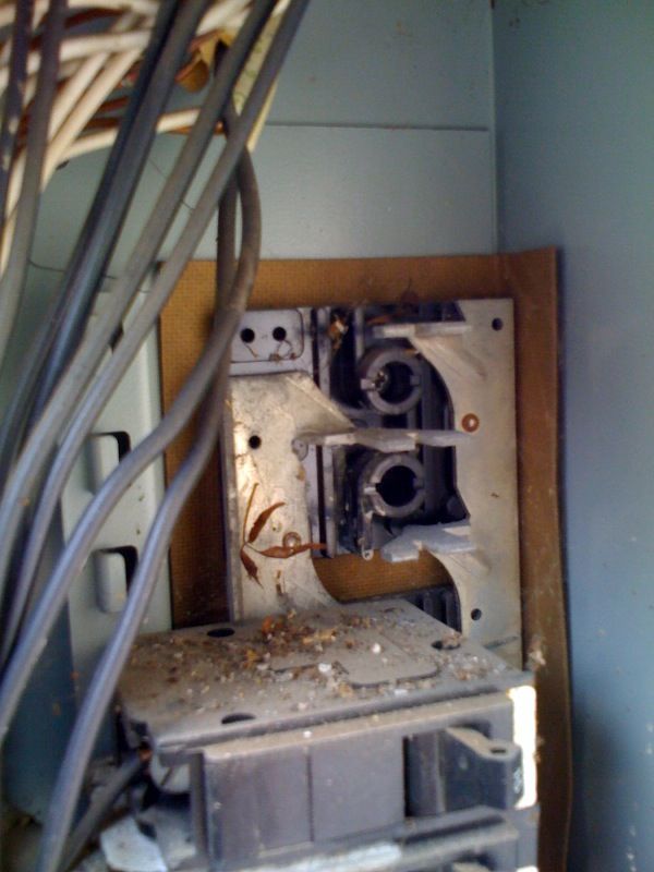

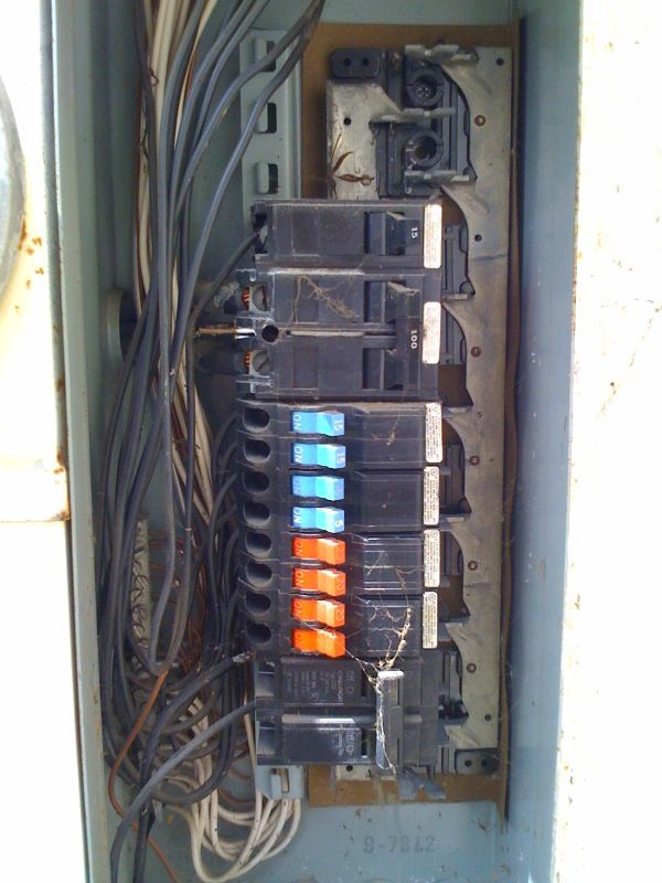

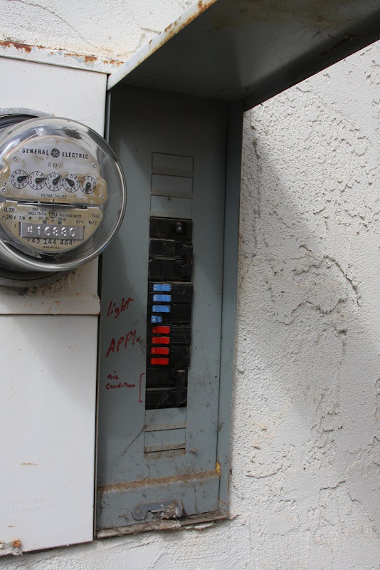

Why in this pic of my box is the main switch in the middle? does it still shut off all breakers? (I haven’t tested it as I have a lot of electronics on and don’t want to shut them off yet)

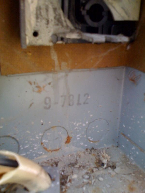

Also, the box says GE on it and the only number on it shows 9-19L2. Short of taking a breaker out and taking it to HD what kind of breakers fit? It looks like I have 5 spots open, so 2 will be for the sub panel box and the another for my 20amp dedicated outlet. Any reason I shouldn’t put them both at the top?

the main CB will kill all the bus power, ie, all breakers...
it's a 100A panel, not sure how much you can add, you need to check the load...
turn EVERTHING on, heating or cooling, etc. and see what you draw with a amp probe...
still won't have much for the subpanel..
it looks like only 1 space at the bottom
adding one 2P and one 1P at the top shouldn't be an issue...

on the inside pic it doesnt show it, but there is space at the bottom for two full breakers. i just have never seen a main CB in the middle like that.

The buss bars do not have lugs to feed them, the buss bars are back fed thru the 100 amp breaker. It can be mounted anywhere on the bars, I guess they didn't have enough wire to reach the top. The backfed main is legal, but is required to have an approved lock or screw to retain it in the panel so it cannot be easily removed. Cannot tell from the pics, but it may have a recessed hold down screw in that hole in between the two halves of the main breaker.
That is one of those "western style" main meter/panelboard combos that puts the breakers outside.
Those grey aluminized finish stabs with the notch in the middle of them is indicative of a GE stab.
The bottom double pole breaker looks like a Siemens or possibly a Bryant, which will plug on a GE stab (but technically may not be legal to do so due to UL approvals). The breakers with the colored handles look like Federal Pacific breakers, but that is certainly not a FP panel, and FP breakers won't fit other panels, unless FP made replacements intended for other panels.......... doubt that.

i dont think the house has ever been rewired, so i figured those red and blue brakers were orginal to when the house was built (built in 80)
