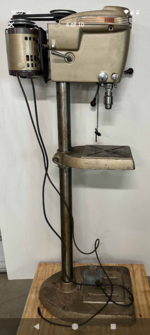

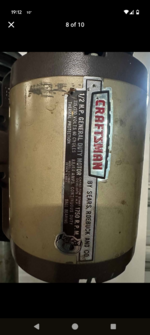

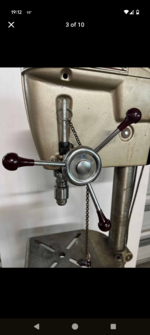

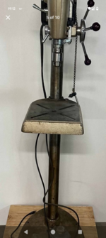

Howdy folks, I was on the hunt for a drill press, ready to buy a new Jet 2550 or some such thing. And came up on a craftsman 150 on Facebook. Your forum seems to be the spot to talk about them, and I have a few questions.
1.) In the 'stock' configuration it seems you can only get the speed down to around 600 rpm, I'm looking to mostly drill metal so would like to get down closer to 150-200 rpm. Is there a relatively simple way to reduce the speed for my use case?
2.) This one appears to have a foot pedal, I'm not super into that. Do you know if these are intended to be operated without a foot pedal, or is it involved to change this? (I am not an electrician, but am willing to do simple things)
3.) What concerns if any beyond normal drill press things should a fella look out for when I go down to look at it this week?
Apologies in advance if I have broken any forum conventions, it's always spooky saying hello and begging for information on a new forum!
Cheers, Austin

This one does have the middle speed pulley, which is both rare, desirable and expensive. So it is already set up to be slowed down to metal-working range.
The foot switch seems to just have a plug in the side, so while the motor may or may not have a switch, removing the foot pedal may be as easy as unplugging the cord.
I don't see any specific red-flags (all handles there, quill isn't dangling, has the depth stop, etc). Paging @FrankLee as he has seen a ton of these.

You can tell by looking closely at the top of the column. The motor pulley also has the smallest step on top, which wouldn't allow you to change speeds if the middle pulley wasn't present (the front spindle pulley is smallest on top).
Here is the manual for the middle pulley, showing possible speeds. http://vintagemachinery.org/pubs/222/7313.pdf

That is an early 150, probably 1958 to early '60s. It has many of the upgraded parts not present in the earlier machines.

As Cruzan pointed out above, that 150 already has the speed reducing Multi-Speed Attachment.

Yes, that machine has a foot switch, but that style is rather awkward. I really like a foot switch with the toe guard. It looks to me to be hard-wired in, but it's an easy thing to undo.
That one appears to be minimally neglected, but not abused. The milled surface on the table is in excellent condition.
As Cruzan also pointed out, there does not appear to be any missing parts.
Things to check out:
  • cracks in the cast iron.
    This is uncommon, but look at the rear of the head casting around the column. There is "seam" where the two halves of the casting mold met. This is a vulnerable spot because it is a thin area which takes a lot of stress from the column lock.
    Another spot to check is where the motor mount rods enter the head casting. Also rare, but I've seen cracks there.
  • spring
    Look down through the top of the head casting and check the end of the spring where it protrudes from the pinion shaft. The spring should not be deformed.
    For reference, check this ebay listing. This spring is deformed. https://www.ebay.com/itm/286247854243

    Fully retract the jaws of the chuck. With the machine running, place the tip of your finger on the body of the chuck below the key holes. Feel for any wobble or vibration.
  • bearings
    Remove the belt (easy to do; lift the motor and remove the belt from the spindle pulley).
    Turn the spindle pulley by hand and feel for any roughness or hesitation in the bearings. New bearings are easy to find and not terribly difficult to replace.
    Turn the motor pulley by hand. Feel for any roughness in the bearings. Listen for any unusual noises.
It looks like a decent machine. The price is high, but prices vary widely by region. Anything not right can be a negotiating point.
If you buy this machine, imo, it's safest to take it apart for transport.
