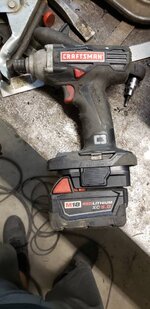

Adapter for 19.2v to Milwaukee m18 or dewalt 20v arrived. Battery is a little loose but it works good. 74f58583e6f233f530d5c849a0dda7c5.jpg

I assume you are loosing a bit of power using the 18 volt battery. How is the life and power as it wears down?
I am not here to bash but to learn and to share what I have learned.
Haven't used a full battery on the yet. Torqued a nut to 200ft lbs and my old craftsman impact took it off so still has enough power.

I'm not really "up" on electronics, but it's been explained on here that the 19.2v isn't really all that accurate and the tool motors are designed to run 18v anyway (Ryobi is only advertised as 18v on the same tools).

The batteries are made up of (5) 3.6v nominal cells, so the actual nominal voltage is 18v. The 19.2v is (5) cells at a fully charged 3.85v.

Generally, Li-ion go from 3.6v nominal to 4.2v fully charged. That "fully charged" voltage rapidly drops to the nominal voltage when you start draining the battery.
Some more info is available at https://batteryuniversity.com/learn/article/confusion_with_voltages
Sent from my Pixel XL using Tapatalk
Yeah, you're right. The full fresh-off-the-charger voltage will be 4.2v-4.3v. The 3.85v is also nominal but of a different chemistry than the 3.6v. Or, they are basing the nominal voltage off a higher max charge voltage? I really don't know, but always believed the 19.2v to be marketing ****, with the batteries really being 18v. Even DeWALT's 20v MAX batteries are really 18v nominal.

Yep, it's marketing ****. The 18–20V batteries are all 5 cell jobs. 18÷5=3.6, 20÷5=4.
