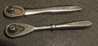

Bought a bunch of **** from a Vo-Tech this week. Actually, got a lot of REALLY nice stuff, but came with the usual load of **** that one must sort through.
Got two REALLY nice SK swivel head ratchets, full set of Snap-on metric deep sockets 9-19, a set of Craftsman 3/8 drive thin wall deep sockets and a very nice 1/2" Dewalt impact wrench, barely used.... but i digress.
The ratchet on top I have owned for quite some time. KZ-44995. I find myself reaching for this over the other 3/8 ratchets in my boxes. Very comfortable, and as you can see, the only thing that even shows wear is the selector lever. Not one chip or peel in the chrome.
My questions are on the other one. 24967 L-AD. I did a search and can't find much info. I found a couple for sale on ebay. They have the same number, but the letter code following the number is different.
I suspect the letter code is a date code. Is that correct? Also, as you can see, the quick release button and mechanism is missing. Is there a repair kit available? If so, what part number am I looking for?
I suspect the guts on these are interchangeable between the two bodies. Can anyone verify?
Lastly, can anyone date either or both of these ratchets?
Thanks for any help.

Looking on ebay it seems Craftsman 2885 rebuild kit is the one for the 24967. One listing says it can work with your other ratchet, but one is coarse and one is fine. Don't recall seeing the 24967 style ratchet before.

That USA made paintbrush handle ratchet is actually really nice. Wish I had one!
I highly doubt the mechanisms are interchangeable.

24967 “L” is the plant in China and “AD” is a date code, 2014 to be exact.
Your “KZ” ratchet is a 2010 date code. KAA or AA is 2011, AB is 2012, AC is 2013 and so on.

"24967 “L” is the plant in China and “AD” is a date code, 2014 to be exact."
Makes perfect sense. I suspected it was off shore as no "usa" anywhere on it.
Coming with the spline drive set would explain why there are so few of them out there.
"Your “KZ” ratchet is a 2010 date code. KAA or AA is 2011, AB is 2012, AC is 2013 and so on."
Was thinking I owned it longer than that, and it wasn't new when I got it. But then, it is always possible I am not remembering correctly. It is the most comfortable ratchet I own.
So, is "K" the code for the forging plant? If so, do we know which one?

Just FYI, yes, the guts interchange. Because they are different tooth count, of course you need to use both the gear and the anvil.
Here are two pic with the China made ratchet sporting the guts from the USA made ratchet. For some reason, the USA made one switches from on to off more easily than the Chinese model. Go figure.
