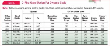

Thanks Edgar. The stretch % will help when order orings from a hard part size.
Rule of thumb.. As I stated earlier you don't want the oring to "stretch" around the part too much because it reduces the sealing area of the oring. On rod sealing applications, I like to see the oring leave a clean surface behind when moved by hand, this way when under pressure with a proper cross section it will provide a good seal.
