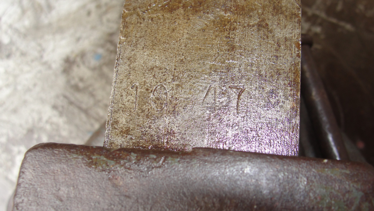

Restoring my boss's recently deceased FIL's Craftsman 5162 vise he is trying to get an idea on how old it is. Stamped on the inside of both jaw's and underneath on the bottom of the slide is "10 87" Am I to assume that is a production date? Does anybody know the years the 5162 was made? I believe these were made by Rock Island. When did Rock Island cease production. Thanks for the help.
Rileysan
Sep 11, 2015
4,298
Milwaukie, Oregon
It probably reads 10 37, as in 1937. These were in production throughout the 1930s to about 1942.

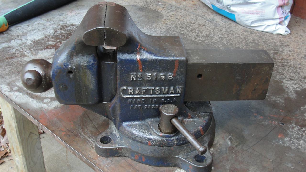

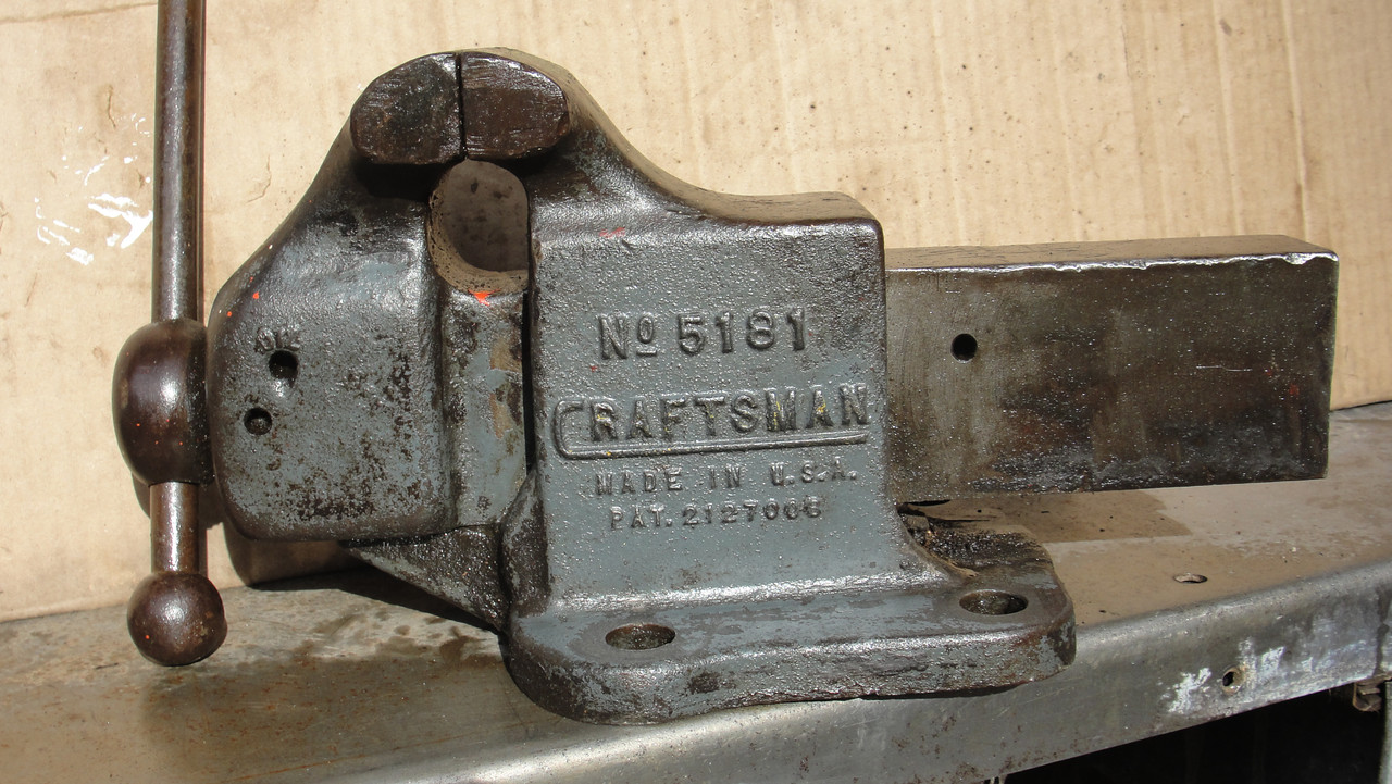

original gray 1 i have. click to enlarge images.
original blue 1 i have.
date stamp on top of slide of the gray 1.

Wrench: while I also like your old Craftsmans they were made by REED and not Rock Island.
RM: your Rock Island made 5162 was probably the same colors as Wrench's Reeds cause those were Craftsman's colors, but since you've got it stripped you might want to put on a couple light coats of BLO and see how your friend likes his vise NAKED cause I sure like them that way. here's my Reed 4c still waiting for me to find a spot for it and make a stand that was sandblasted and had 2 coats of BLO put on it over 4 years ago now and all it's needed was a simple green cleaning to wipe off shop dust and it's still not rusting.
also found some pics of a 5162 I think I still own that might be grey under all the surface rust.
ALL: Rock Island made vises for Craftsman before WWII and probably late 20's and 30's is the range and with the long C on their sides. I'm pretty sure Rock Island made the 519x's before they closed their doors for good in 1957.

i believe my 5186 is original highlighted lettering, even when i posted the find years back. double click on photo should enlarge it to the max.

You can figure out the date by looking in the right area on your vise. If it's like my 5163 which was built by Rock Island, you should be able to see a three or 4 digit stamp mark on the lower right hand side of the dynamic jaw tower as you face the vise. You can see "634" stamped on mine in the first photo in this link:
https://www.garagejournal.com/forum/showthread.php?t=392284&highlight=maui+5163
You may have to enlarge the photo to see it clearly. Mine was manufactured in June of 1934.
Maui
I found the stamping or casting not sure but mine is "593" so that doesn't help. I guess I will figure between 1930 to 1942 seems to be the accepted range.

RC: Rock Island used to date stamp their vises on top of the dynamic slide just behind where the static jaw is when your vise is closed. any chance you can post up a few pictures of your vise? I just click on the paperclip above where we write our posts and attach thumb pics sort of like you would an email attachment and if member wants to see it full size it only takes a couple clicks.

Retroman, can you post a close-up photo of that stamping? Drives, mine has no date stamp on the top of the slide. I do have other Rock Island vises that were manufactured in the 1940s and 1950 that are stamped on top of the slide. I think that there must have been a particular year where they started stamping the top of the slide, but I don't know what year it was. The earlier vises were apparently date stamped differently.
