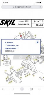

I have saw a purchased about 30 years ago, it has a little higher than average home use, my wife and I GC’d two houses. When start it, it cuts off with no load. I opened it up, the brushes did look that bad though could be replaced. The price of brushes was high enough, around 35 on Amazon, I thought it not worth spending on a 30 year old saw that was low end at the time, just your basis Sears’s homeowners saw. Any suggestions before I toss it? I used the excuse to upgrade to an M-18 Fuel 2631, which I’ve been wanting. I found it interesting almost all the Milwaukee saws are left handed, I’ll post a different thread on that topic

What does could be replaced mean? Either you have brush material or not, though long term heat could have softened the spring/mechanism so you could try to put a little more tension on them, and clean the commutator if it looks bad.
Otherwise, I'd look at the trigger switch. If you feel comfortable working with it open then you can use a multimeter to see if voltage is getting through without substantial resistance when it cuts out.
"IF" the switch can be non-destructively opened (probably not, though maybe rivets and you could bolt it back together), I'd do that and clean the contacts. If it can't, then see what a replacement would cost. It's probably just a standard issue, standard form factor switch so something you could get at a well stocked electronics supplier, like Digikey in the US.
The switch is obsolete.
