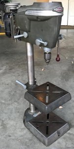

Other than making pulleys I hadn't had a lot of drill press specific activities going on in the shop lately until a local GJ'er helped me back into it by picking up a "problem" drill press for me.
It turned out to be a 13.5" Craftsman in a pile of parts. The pot metal quill lock had seized in the head casting so the owner continued to use it by simply forcing the quill up and down. This action eventually caused the spindle to loosen up and start to back out of the top of the head casting.
Apparently this poor problem drill press got put into storage for a long time until it was eventually taken back out and given to a friend. This friend was not drill press savvy and attempted to use it in some unsafe ways because it was not working properly. After a number of stitches in his hand his wife informed him he was selling it.
This drill press got a light cleaning and a fresh set of premium sealed bearings from Accurate Bearing. The motor bearings were cleaned with brake cleaner and repacked with grease in situ. This method worked perfectly and was a lot easier than pulling the motor casting apart. The final "touch" it needed was some Prussian blue on the quill to determine a high spot causing the action to be less than smooth. The end result was a very smoothly operating press:

The story doesn't quite end there. The buyer of this restored drill press gave me yet another drill press as partial payment. This turned out to be a cute little sleeve-bearing Companion press, totally original. It was pretty interesting to see how this little guy was put together. They are very easy to work on. The quill has one single ball bearing which is an odd-size thrust bearing at the end. I was again able to save this one by thorough cleaning and regreasing.
The end product turned out very nice and it went to another good home. Now I only have my own drill press in the shop and it's getting lonely again :)
