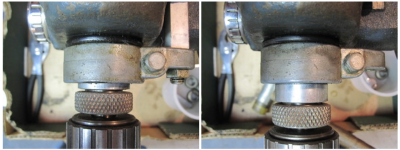

The Quill Snap Ring
In my Craftsman Drill Press Evolution post, I mentioned that at some point, a groove was added to the lower quill to allow for a snap ring.
I believe that snap ring may have been designed for use with the mortising attachment or other quill attachments when removing the original feed stop bracket. It also serves another very important purpose. Here's how...
Prior to the snap ring, the quill gasket along with the feed stop bracket clamped to the quill act as a bumper when raising the quill.
The picture below on the left is how I found the feed stop bracket on dp#16. Over time, after many cycles of lowering and raising the chuck, the feed stop bracket slid down the quill.
The picture on the right is after I fully re-seated the feed stop bracket on the quill. The difference is about 3/8".
Below are a couple pictures of the top of the quill when fully raised. With the feed stop bracket out of place, the picture on the left shows how the quill raises higher into the head frame allowing the spindle collar to make contact with the bottom of the spindle pulley shaft. The picture on the right shows the proper position of the quill when the feed stop bracket is fully seated on the quill.
When the spindle collar makes contact with the spindle pulley, the outer race of the lower bearing bumps up against the retaining screws. That's when the screw becomes bent and damaged. Sometimes, it's nearly impossible to remove them.
The quill gasket installed above the snap ring provides an absolute stop for the quill and prevents damage to the retaining screws.
6-28-2018
Reseating the Feed Stop Bracket
Quote:
Originally Posted by KJ2018
Have the subject drill press that I began work on. Mainly clean up so far. Has a light grinding noise while running.
Quote:
Originally Posted by FrankLee
The grinding noise could be the feed stop bracket rubbing on the threaded spindle thrust collar. Verify that the feed stop bracket is fully seated onto the quill. I can see a gap where the quill bumper should be contacting the head frame casting.
Let me ask you about that gap. What do I need to do to correct that? ...
  1. lower and lock the quill
  2. loosen the nut at the bottom of the feed stop rod
  3. loosen the nut/bolt on the feed stop bracket
  4. push up the bracket onto the quill until fully seated
  5. re-tighten nuts and bolt
  6. unlock quill
In the past, I have used a low strength thread locker/bearing mount compound on the quill/feed stop bracket on machines without the snap ring.

8/21/2015:
Table Lift,
aka, Head and Table Adjusting Mechanism for Drill Presses and the Like
So, I looked up the patent for the table lift 2260635; actually the formal name is Head and Table Adjusting Mechanism for Drill Presses and the Like. The file date is March 26, 1941.
In the patent drawing, the thrust bearing (part #30 in fig 2) is shown installed on the inside of the gear housing and is designed to support the weight of the head frame, if that is to be adjusted. On drill presses equipped with Multi-Speed or Vari-Slo Attachments, the head frame must remain stationary.
My lift is installed such that it will only adjust table height. That is why I have the thrust bearing installed on the outside of the gear housing; so it can support the table weight. Otherwise, it would serve no purpose.
Right you are, FrankLee... The thrust bearing was indeed inside the housing... One nice thing... It was a nice bearing... I mean literally. The bearing manufacturer was "Nice" :^)
Here are a few photos during the mid-stage of cleanup... Just after chipping off the fossilized grease.
BTW, I decided against repainting the lift. A little cleaning brought the paint back to a very cool Navy-like gray that matches my floor press. (guess where the lift lives now!)

8/23/2015:
WOW!!! That's a nice score! Very nice table too.
I don't see a thrust bearing on that gear box. Please take some pix when you open it up.
That lift looks to be in great condition! Good call on not repainting. I will seldom repaint anything unless absolutely necessary.
I just got a new thrust bearing last week, I need to check out the original again tho, the new bearing is from PRC.
Get it SHINY ... then apply some Johnson's paste wax ....
Yes, Johnson Paste Wax on all bare metal surfaces is a good suggestion.
