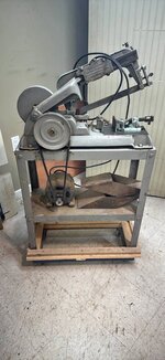

With careful fiddling, they can be made to cut accurately, slow, but fascinating to watch. Here's mine with a custom base/tray. They usually sell for $100 around here.
