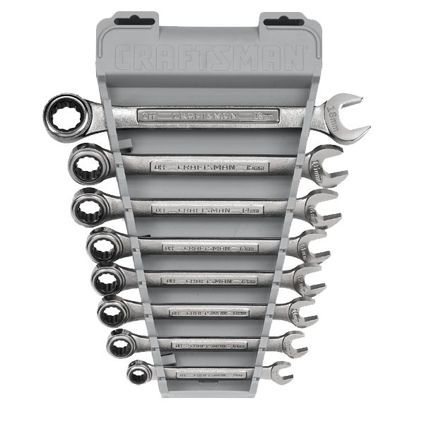

I am looking to pick up some ratcheting wrenches. I've noticed there are several styles out there.
There is the "pawless" wrench, like pictured here:
00942445000
Then ones with the polished finish like these, coming with reversible, secondary action etc:
00942404000
How are the pawless ones?

I own the reversible polished ones I got at Kmart years ago I got there at clearance for $15. They are very nice, high quality wrenches, but they do not come in any usable case.
The pawless ones look very much like their run-of-the mill basic wrenches with a ratcheting end. They're subtantially lower quality, feel lighter, metal is softer. I've had several of them simply slip when more torque was applied - the jaws would simply spread!

The pawless ones are average at best.
I have an SAE and Metric set of the reversible Craftsman wrenches. High polish, excellent quality and I've yet to have an issue with them after 3 years of use. I would like to note that my sets are the old USA made series. I don't know if you can get the USA made sets anymore.

The polished set pictured is desirable old stock that was made in Armstrong Factories in the United States. They are not as long as Armstrong reversible ratcheting wrenches nor do they have the opitorque modified open end.
However, they are great ratcheting wrenches. They are finished nicer than anything with Gearwrench stamped on it, have thicker beams, and have a crisper ratcheting action. Sadly, current versions are made in the PRC and feature crab claw open ends.
Now, those pawless wrenches are pitiful. They have like a 36 tooth action that just *****. They were phased out in regular Sears stores quite awhile ago. I would avoid those.

Pitful is an understatement! I was given thoughts pawless ones for a gift 5 years ago. They are complete sh*t! They are so rough, it makes their ratchets feel smooth. I saw them at a local ACE and they want $60 bucks and change for them. I am replacing them with a Genius set. Avoid like the plague!:drool:
