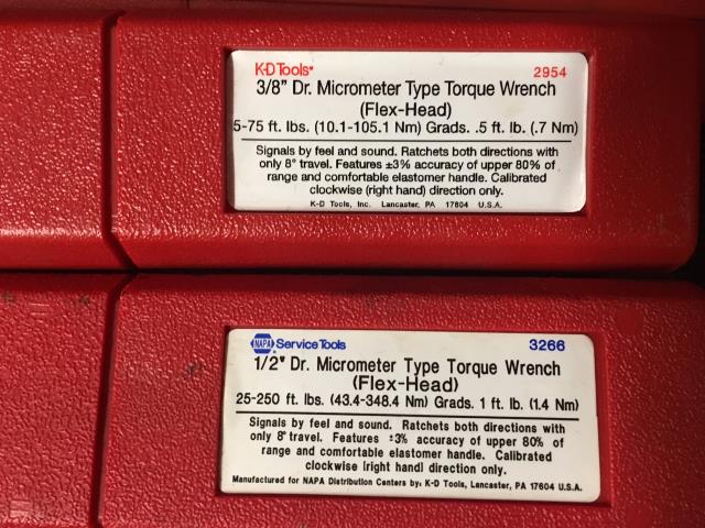

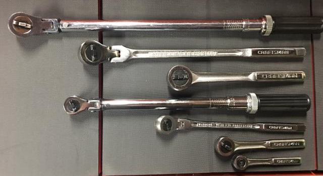

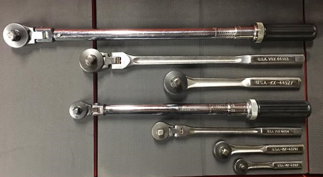

Figured I'd tease my RHFT stuff here.
The ratchets themselves are late-production Craftsman, but, I've not seen my torque wrenches show up here:
The torque wrenches are KD production:
Later models with the same part numbers have the standard (and much-lamented) 36-tooth head.
Haven't been able to find a RHFT 1/4" drive torque wrench yet, dunno if they ever produced such a beast.
