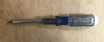

Trying to square what I am reading with the photos attached. WF on top, but the bottom one I assume is 'Circle F' but it does not say 'Super Tuff' on it anywhere. I also have a large Vanadium labeled screwdriver that seems to be just 'F', no circle that also does not say 'Super Tuff' on it. I would expect that both were made prior to 1966. PXL_20211215_032314539 (2).jpg266419879_10222638235763045_5092495496377869077_n.jpgPXL_20211215_035405948.jpgPXL_20211215_035812216.jpg

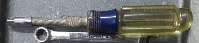

I'll post a digression here because no one seems to know the manufacturer code, and the tool has a screwdriver handle:
Craftsman 1/4 drive flex spinner.
Pointed A in the Craftsman logo. Circle V (V) for a code.
The knurled section on the shaft is very much like earlier amber handled versions, but this one should have been made much later. I found several examples online with similar handles, but no (V) codes, and none had the knurl on the shaft.
I have to believe that these were made by a screwdriver vendor, since molding the handle was a much different from forging socket wrenches.
Ok so I looked through the catalogs, and in 1955 Sears stopped using "Super Tuff" in the listings for the screwdrivers, and advertised Chrome Vanadium. This is probably when they took the Super Tuff off of the drivers. In 1965 Sears started using Super Tuff again, but only in advertising, as the screwdrivers continued to be marked Vanadium until about 1970.
I will fix my research later.
When I did my nut driver research Circle V was MDF and later Easco. They probably outsourced the handle to somebody else though. You will occasionally find sets with both G and V codes.
