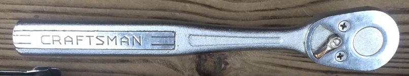

This is cool. When were the ratchets with the V selector made? My dad had one ratchet and it was a 1/2" with the V shaped selector lever. He died in 1991 when I was 15. I've always wondered how old that ratchet was. When I was a kid it wasn't exactly a priority to ask.
AceofSpad3s
Oct 1, 2014
1,808
Just had this conversation. They were produced between about 1959-1966.
FYI - Officially, Craftsman referred to them as Butterfly selectors. They were replaced by the Long Lever selector in 1967.
Pre '67

Jim I've noticed some of what you are talking about since I have started collecting.
The 1/4" -v- seem to have a few iterations even with the same product #. Some have the oil port and some don't. What is up with that?
Gear Wolf
Feb 25, 2015
567
That is a great piece of information to know! Thank you. I thought something was wrong when it took me a few months to find a non-oil port QR 1/4".

My best guess is they are Type 9, however there is some information in your study that may suggest otherwise...
The makers code on my two ratchets are -V- , I believe your study is showing Type 8 and 9 should be a -VV-?
Both of my two ratchets have the two piece QR mechanism. I believe you mention in the study that the 1/4” drive ratchets with the two piece QR mechanism should only be found in Types 3-5?
Am I close? Can you help? Thanks in advance and thank you for all the time and effort you put into this study. See attached photos:

As I was paging through your thread here, I noticed that you were missing this type. Perhaps you've collected one up in the interim and it will appear in the update?
This is the only pic I have on hand, but I can snap some more if you're interested. The model IIRC is a =V= and it has the OH on top. Foundry mark of B up near the head of the ratchet.
