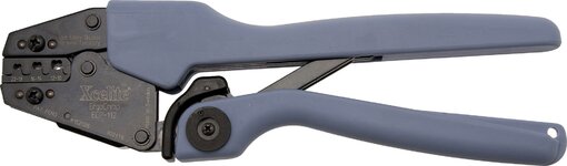

I know this topic has come up before, but let's beat it to death one more time !
I have TOO MANY different crimpers. What I would like is a ratcheting crimper, probably with interchangeable jaws, that can crimp typical insulated and uninsulated terminals in the wire range of 12AWG to 22AWG. Crimping weather-pack terminals and other POPULAR automotive terminals is also desirable.
Jaws for larger and smaller wire sizes is a bonus.

I've been very satisfied with the Wirefy Crimping Tool. It'll do heat-shrink, nylon, non-insulated, and ferrule terminals with removable jaw sets, but it's limited to the three standard sizes for the terminals (12-22). Bought the kit on the zon, about $75. I use the hell out of it and I think of all the crappy crimps I'd made in my past, using the cheapo one I had before. The ratcheting feature allows the set-up to get the wire properly inserted and then the allows for a good solid crimp in the right position.

The ratcheting Wirefy is nice. Lots of import brands sell the same basic ratcheting crimper, but Wirefy has a lot of additional dies you can buy, and the kit I bought has room in the case for additional dies.

I originally bought the Astro for doing Deutsch terminals. Then latter bought the Knipex multi-crimp. It does everything and does it extremely well. The 5 sets of dies it comes with does just about everything except for specialized stuff and they sell additional dies to do anything specialized. I cringed at the price when I bought it 10 years ago, but every time I use it, it makes me smile as it makes a perfect crimp every single time. Non of the other crimpers I had in the past did nearly as well.

Automotive terminals are very specific. Crimp dies are proprietary per series and size. If you want some real good stuff, Rennsteig PEW12 frame with dies for each of your terminal that you’ll crimp. Changing dies is a hassle if you have to do it with any frequency, so I have 7 PEW12 frames each loaded with my everyday dies. The PEW12 frame is also sold by Knipex in bare frame or with universal red/blue/yellow dies like insulated or none **** splices etc. Rennsteig and Knipex are related one way or another. They also sell the PEW12 frames private labeled for some OEMs like TE connectivity that use them as the official tool for some of their terminals.

99% of my wiring crimping involves heat shrink connectors so I have a pair of Ancor single crimp ratcheting crimpers for use specifically on heat shrink connectors:
You cannot use standard crimpers on heat shrink connectors because they are likely to pierce the insulation.

Have used these for several years (Knipex make a pair too but they are way more expensive) but I've had 0 problems with these.
If you want the bigger ones for lugs (like battery terminals etc) I've used these for a while too pretty sure they are a vevor rebrand or whatever.

I have a Wirefy and Titian Tools, dies are interchangeable. Wirefy is a bit bigger for more leverage. Have dies from several different vendors.

I'm not a fan of the ratcheting ones. Insulated, uninsulated, heat shrink, whatever typical connectors or splices I find for automotive, pumps, blenders, etc. I do with my Klein 1005. But I don't encounter coax, RJ45, Deutsche, or other special connectors on what I'm working on, but if I did, I'd go for a ratcheting type with the correct die because that seems to be the only option. I do have a pair of Blue Points that I bought long ago that look exactly like the Laser one that richfinn posted, but used it only for a few crimps before going back to my Klein. I feel I get a better crimp, but your mileage may vary.
Pro tip, from the non-ratcheting front. If you want a pair that can cut wire and do proper crimps, guaranteed, out of the box, get a pair made by Ideal or Thomas & Betts. They are more expensive, but guaranteed to be intolerance for cutter size. With Channellock and Klein, it's a crapshoot, where the cutter may be too large and not allow your to clamp down enough to get a decent crimp. My Kleins must've been that Winchester '73 "One in a Thousand" pair, because they worked perfectly out of the box. But I had friends that had the same tool and couldn't get decent crimps, and comparing them to mine, we could see that the cutter is too large, and didn't allow the crimper portions to fully close, resulting in poor crimps. I have a friend whose bread-and-butter is building reproduction harnesses for cars, and he has both Channellock 909 and Klein 1005 where he ground the cutter portion off, mainly so he could do the flag-type terminals but it also lets him clamp down enough to get good crimps on anything else.
