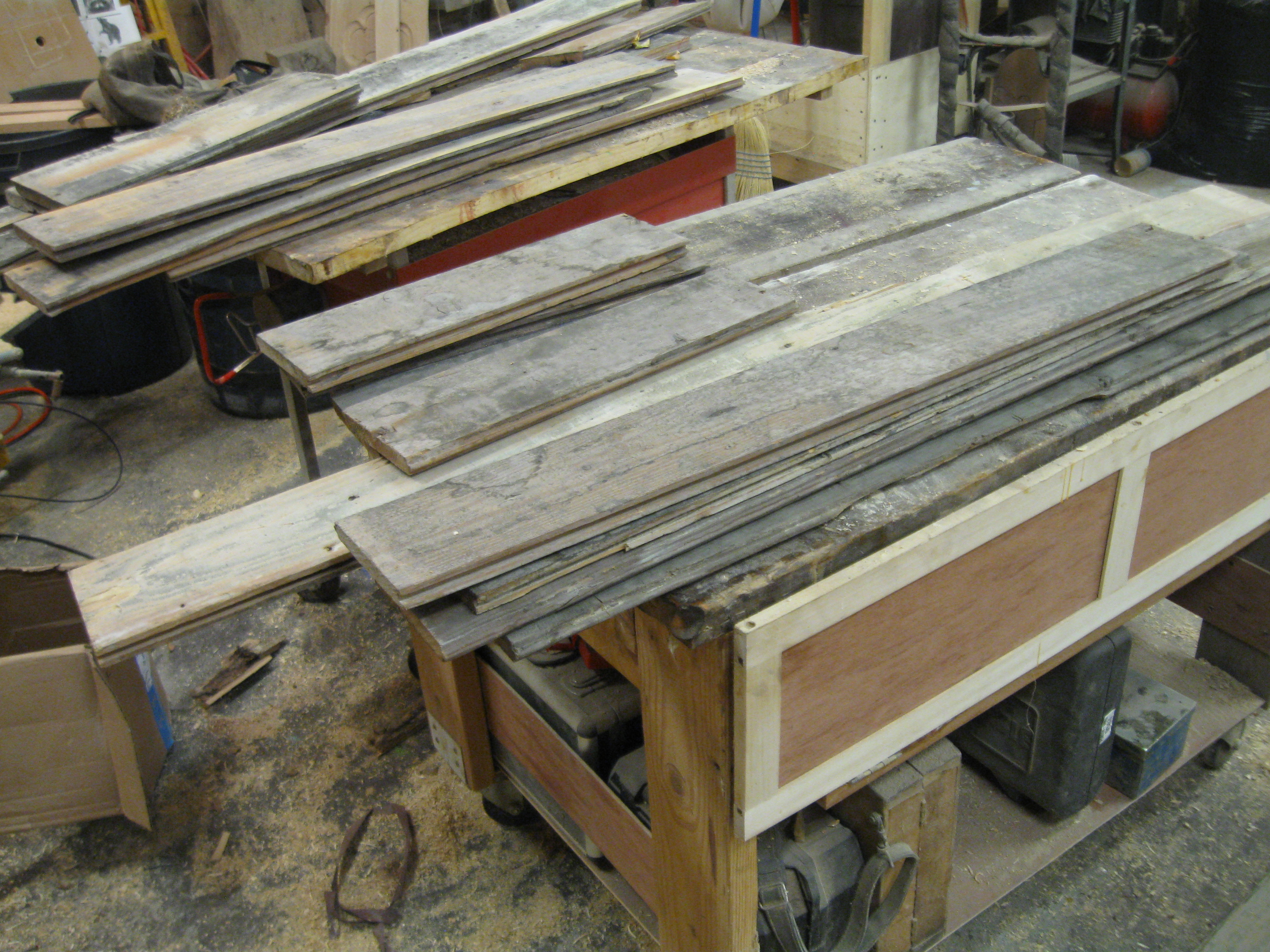

I was commissioned to carve a crucifixion for a church. It is being renovated so they gave me some of the old church pew wood for the carving, the wood is red Oak.

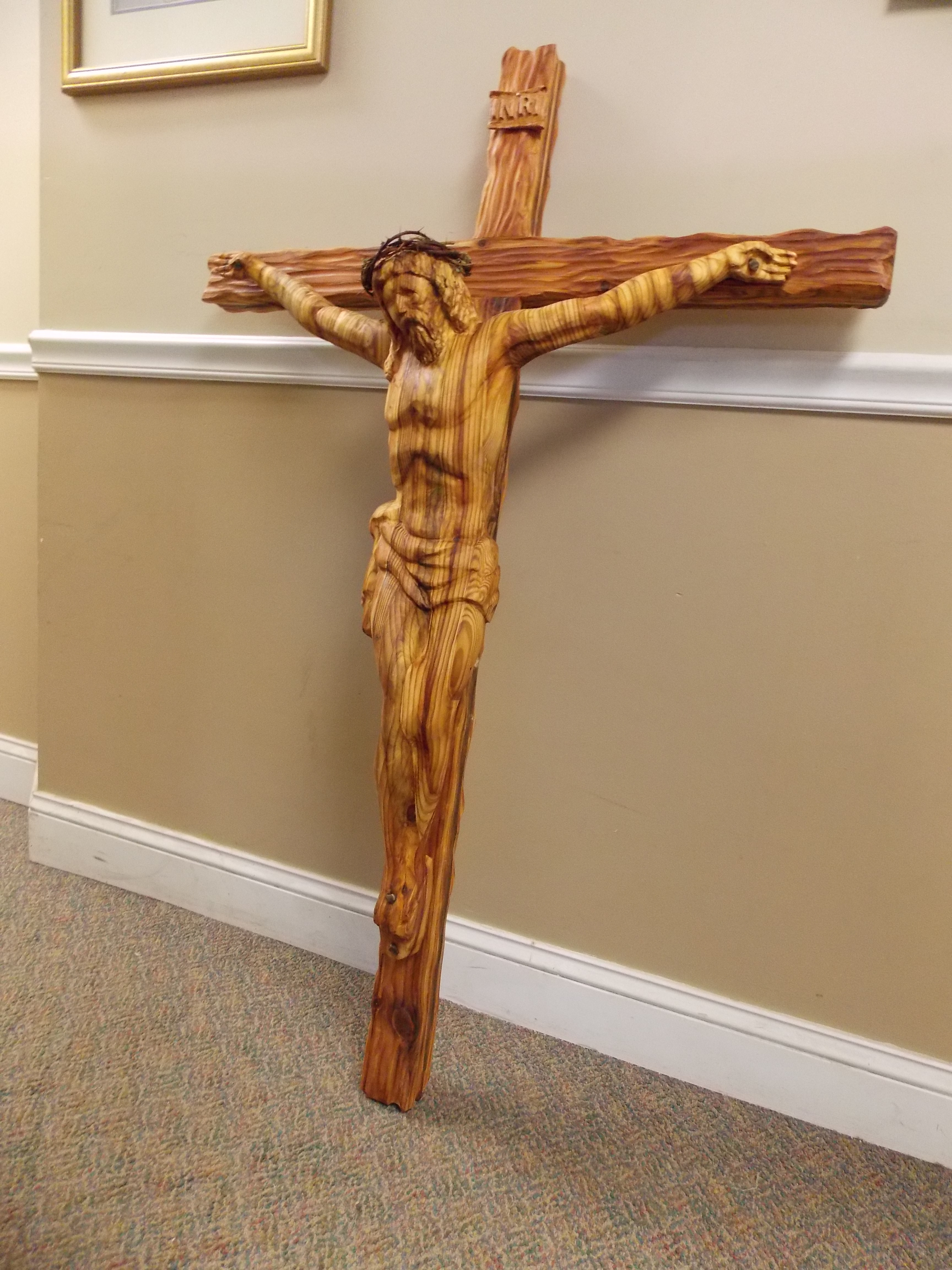

I decided before making the church one to do a practice run so I glued up some tulip poplar and made this one. It gets roughed out on the CNC router I have a computer model that is low detail but I get the proportions.
I finish it off by hand with die grinders and some little dremels with carbide burrs.
This one is almost done a little more work on the hands and feet

I had a small metal corpus, I used the CNC machine to scan it. I made a probe out of a Tig electrode and mounted it in half inch aluminum rod inserted in the collet of the router, then connected my zero plate wire to the metal corpus it took almost 18 hours to scan a 4" high model.
My software has that ability built in, that was the only time I have used it. If I was to do it again I would use the gamer modeling program Make human, it is free and exports machinable files of humans it is very versatile.

This is another one done a few years ago, a little smaller. When I got the wood I did not have a big expectation of it turning out well. It was the attic boards from the church. Not the same church I am doing work for now. The boards were Fur that stuff is fuzzy and chips easily while carving.
Surprisingly I think it turned out well.

I finished them up, the finish is boiled linseed with a touch of poly to harden it a little more. I forgot the crown of thorns for the pictures I steamed branches from a thorn bush in the yard.
The spikes are drywall screws I heat the heads red hot and pound them flat while red hot I dip them in linseed oil it burns on a black finish.
This is the Oak one the Cross is reclaimed Chestnut.
This is the tulip polar one cross is cherry
