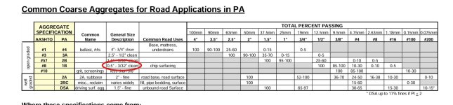

AASGTO is where most state and federal specifications come from. They dont use the term Minus, that is regional vernacular, and surprise, it differs between regions. But they do use " - " They use open graded as the term without fines, and well graded with fines and further specify that its "clean"
I am not paying for the AASTO spec book but here is a document from Pennsylvania to show that just as I displayed in the picture above, the terms are used together. Could I have used "3/32" to mean little tiny rocks in addition to "minus", sure, but its not a double negative.
