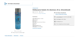

Update...
It turned out that there was a 45 degree angle inside the house near the cooktop.
Therefore, at least some cutting would be required to remove the entire pipe.
However, looking at the pipe carefully after removing rust revealed that the pipe inside the house is actually just fine with minimal if any rust.
There was a focal area of rust close to the wall with a visible hole, but outside of the wall.
All that was needed was to remove the rusted segment, thread the remaining pipe and install a 3" replacement segment.
Finally, to prevent future rust.
There were other areas of significant rust on the outside portion of the pipe, but no more leaks.
Short term, after removing existing rust the pipe was covered with "Seal It" (see below).
This product seemed to work well on other outside pipes, and stood up to weather/sun well.
I am considering removing this and covering with a product to arrest/convert existing rust.
Does anyone have any suggestions re: best coating to prevent further rust?

Glad you were able to fix it. Any oil based paint will do a decent job protecting it. I would have used galvanized and then not worried about it. Just about any coating to keep it from rusting will work.
