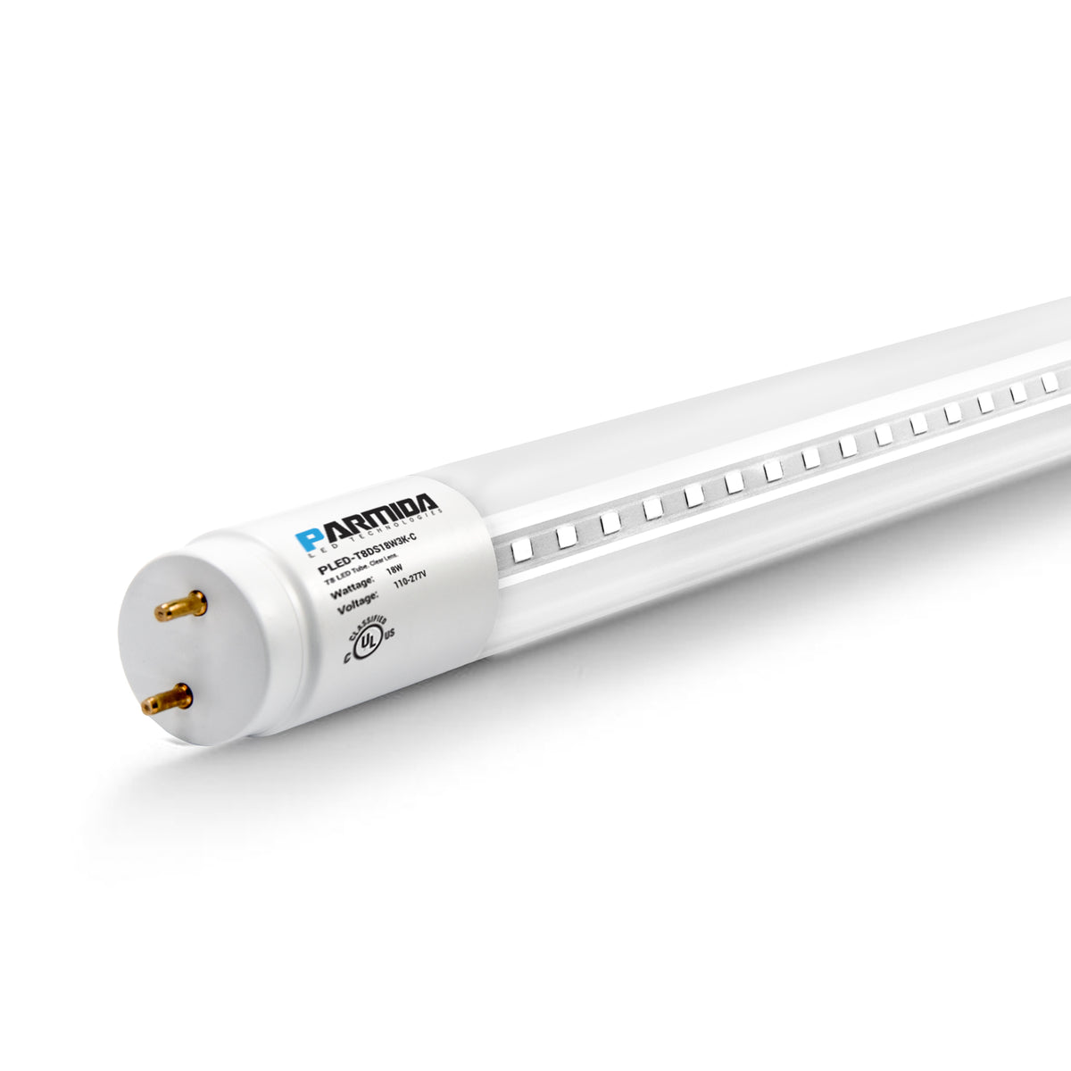

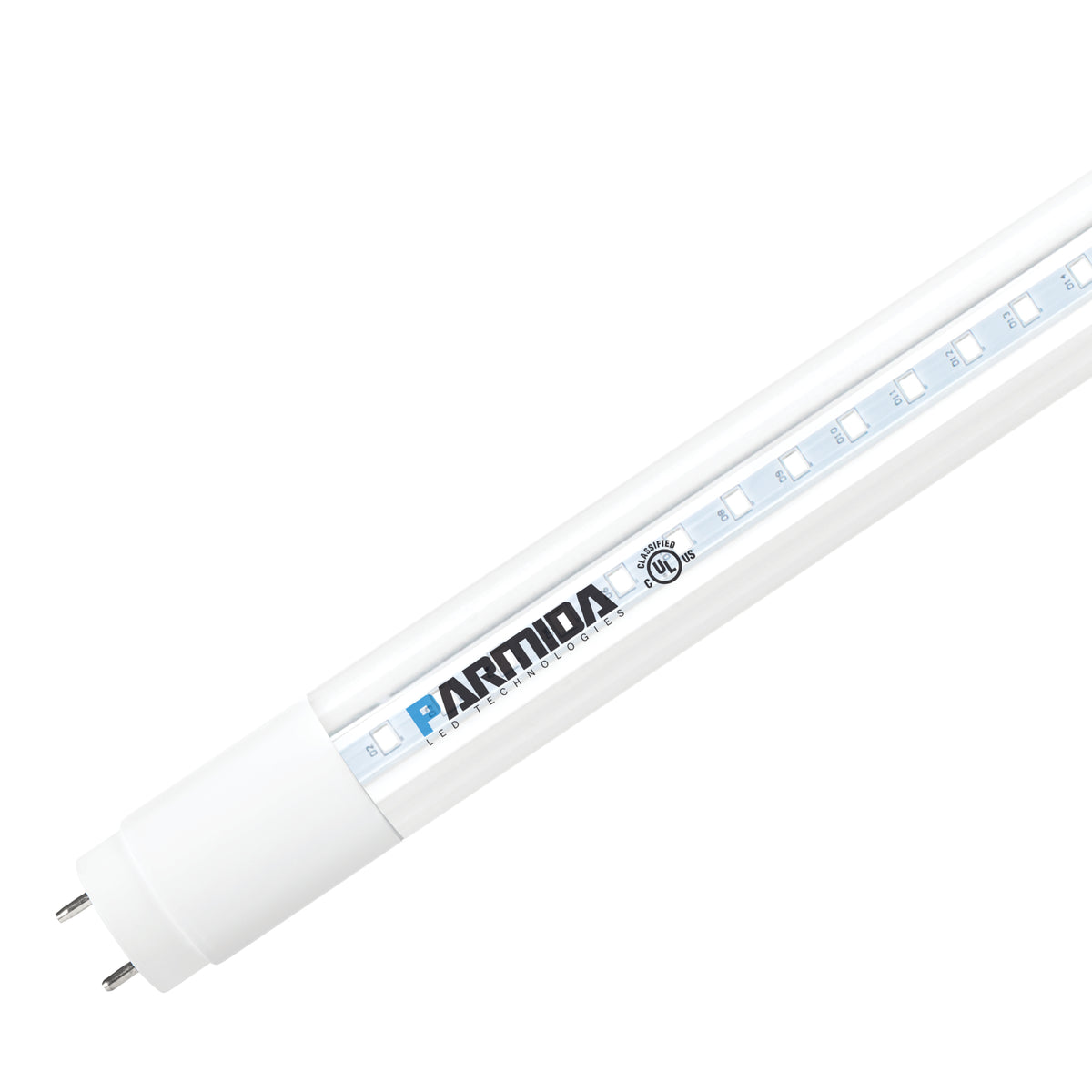

DG930
Nov 19, 2020
105
Maine
I've had very good luck with the Parmida bulbs. Ballast bypass, type B. Not a single failure in 5 years, ran out and reordered recently and the quality had not changed. Multiple color temps to choose from, I went with 4000K.
$96 for a box of 20, free shipping
BroncoAZ
Jun 23, 2018
2,685
For whatever reason, the "acceptable ness" of color temp seems largely dependent on how much light you have. 6000k is pretty close to daylight, but you need an absolute ton of it for it to feel okay.
Most people tend to settle for around 5000k in a nice bright shop. 4100k is good for lower light settings like an office.
I definitely reccomend paying attention to CRI though. 80 CRI is the industry standard minimum. I definitely notice the difference between my new 80 CRI LEDs and the old 90 CRI fluorescents. The color quality just isn't quite as good.
I searched for some higher CRI LED’s, they are expensive at $40 per bulb and less lumens. Maybe a smaller array of those specifically over the workbench would be sufficient.
BroncoAZ
Jun 23, 2018
2,685
These are 24 watts and 3200 lumens 👍🏻
