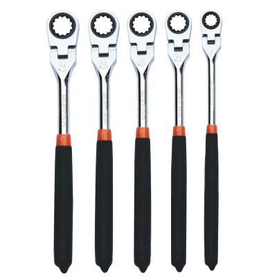

At work this week saw an elderly lady (she volunteered that she is about to turn 60) building loader arms for the mini skid steers we build. I was talking with her for a while and she wanted to show me the ergonomic handle wrenches she had our tooling department make for her. She uses them to backup bolts when tightening lock nuts with an impact. She even made me try her job using a regular wrench and with the ergo wrenches and man what a difference... She said the wregular wrench had caused her pretty severe nerve and tendon damage in her left hand as well as carpel tunnel. Pretty great insight in my opinion.
Wrenches are Proto (as are 80% of out tools) with one end cut off and pipe notched and pressed down over the shaft and welded together. No welding to the wrench, handles look like bicycle handles to me.

Anyway, it's a great idea, and probably something they should have had all along. Wonder if anyone makes wrenches like this.

Those are pretty sweet and not a bad idea. These are the closest things on the market that I could think of. Made by a few others, these are Matco's.
Next best thing would be the soft grip wrenches

I seem to remember seeing an offset box wrench with a hard handle from MAC. Can't place where I saw it, but it stuck out in my mind.

This thread reminds me of these custom beauties (not mine):
The last picture is what MAC actually offered, once upon a time.

Awesome wrenches! I knew somebody had to make some in a similar fashion. But, she likes the ones she has and as long as they keep her from getting hurt, they are great with me.
