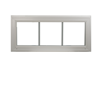

I am remodeling the bathroom in the house. It is a '50s model with a window in the bathtub alcove. Somewhere along the way, vinyl shower surround was added an plastic trim was installed around the window. I am installing a walk-in shower, but I like the light that the window provides. The window is a 30" rough in and I'm not finding a 30x12 window to be a standard size. I don't want it to open, so my thought is to buy a double pane and build a custom frame for it. Since it'll be exposed to the shower on the inside, I want it to be water proof, so PVC seems the ideal material for it. However, I read that PVC expansion is bad enough to cause sealing issues with the glass. Of course, the places I have read that all seem to be websites for window companies advertising their fiberglass frames or other composite materials. I've not heard that from anybody I know who has vinyl windows in their house. Is that a significant issue? Is there a better solution that doesn't cost a fortune?

Go to a lumberyard or building supply and order the size window you need. Might add $50 for the custom size.

Look for Ultrex windows. It's a type of fiberglass and doesn't have the issues of PVC. For non-operable windows, all the major companies will make them to order.

Find a local building supply store who sells vinyl windows (Plygem, Moss, etc). These companies will make any window size you want, since every window is somewhat custom made anyway. 30x12 will probably cost somewhere in the neighborhood of $250 or so. If this is a bathroom window, you may want to consider a tempered glass window and frosted glass if it's at body height.

The reason for the smaller size is so I can place it at the top of the existing rough in. I do still want frosted glass though. I'm going to stop by the place I buy my glass this afternoon and see what it will cost for a ready to drop in window vs just the glass.

I think you also need to make sure that it's tempered glass if it's in a shower location... I biffed this up by installing an outdoor shower near an exterior window and got called out on it as a code violation.
But yea, most window manufacturers do custom sizes all day long.
Personally, I'd use a "picture window" (non-slider). Picture windows are actually a good deal less expensive last time I bought. Clear glass, so the neighbors know what they are missing when I'm taking a shower. :)

Any decent lumber yard can order what every you want. 30" wide is not a stock size for most any where, but can be ordered. I just ordered a vinyl 30x18 hopper for my garage, it was about $300. A fixed window should be less money.

I stopped in at the glass place today and it's 2 weeks to get the glass only. I didn't get a price. Also stopped and priced assembled windows both vinyl and composite. 3 brand, ranging from about $200 to almost $400. Lead times are 3-6 weeks depending on which one I go with. Interestingly, the one that I think looks best is the least expensive and has the shortest lead time. So this project isn't going anywhere this week or next. I'm on the road again after that so I'm not sure when it'll progress.
But, I also was trying to decide on some plumbing fixtures and couldn't find exactly what I was after so I was holding off on buying some of that. There's stuff I could use and if push comes to shove I will, only about a 2 or 3 day wait on that stuff. But I stopped in at Ferguson to clear up a couple questions and left with more catalogs and less certainty than I had going in. This bathroom is never going to get finished!

Not that you asked, and you may already know this, but you'll need tempered glass for your application

Doesn't that depend on how low or high the window is framed in? My understanding is, in most areas if the bottom of the window is over five feet is does not need to be tempered. Some places all glass in a bathroom need to be tempered.

In some areas it will depend on the area size of the glass. Me personally, I would never put anything buy tempered glass in a shower/tub area for safety purposes. One of those better to have it and not need it, then to need it and not have it type of things. Safety first.

I will be using double pane. How much does that help with the window getting ice on it in a bathroom setting?
I have read, as has been mentioned several times, that tempered glass is required for Windows below 50" but I also read somewhere about there being a distance from the bath/shower. Of course, this being in the shower, it'll be within that distance. Oddly, the place I got quotes from did not quote tempered glass, even Knowing it is going in a shower.

I stopped at a glass place yesterday, but they only do glass, not windows. Stopped at Star Lumber, as the glass place recommended them, and got quotes for 3 different brands, but I'm not in love with any they showed me.

When you get this going, be sure to build a pan at the interior window opening that is at least equal to what you would usually do on the outside. Try to place the window out of the splash zone as possible.

Yeah I was thinking the inside could be a mirror of the outside. It'll be in the middle of a 30x60 shower, on the long side. Bottom of the glass will end up about shoulder height, so it'll get wet. I guess I could put up a shower curtain like the window there now has but I think I'd rather go without a window.
