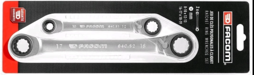

Here are the Facom 64C.S1 (8x10 & 12x13) and 64C.S2 (16x17 & 18x19):
The length of the S1 is 150mm. Lengths of normal ones: 8x9 128mm, 10x11 150mm, 12x13 170mm.
The length of the S2 is 230mm. Lengths of normal ones: 16x18 210mm, 17x19 230mm (which are already odd, because both are for M10 and M12 bolts just in different standards, so seems should be the same length).

Here to scale are the Facom 64C.S1 (8x10 & 12x13) and 64C.S2 (16x17 & 18x19):
My wrench measures about 250mm (10 inches) which is a fairly standard length for an average 3/4 (19mm) wrench, and it is especially nice when trying to loosen and overtightened bolt that someone gave a few too many uga duga's to haha
As for the size choices, they are far apart, but I chose the sizes very specifically for my own need with these particular wrenches. I would say the most common sizes I use almost daily are 9/16, 3/4, 15/16 and 1-1/8. The problem is that if I made a wrench with those two larger sizes, the wrench would have to be at least 12-14 inches long to have any usable leverage. A wrench that long couldn't be packed in my pocket, and as such would ride in my toolbox. If the wrench sits in my toolbox, and I need one of the 4 sizes I mentioned, why would I not simply grab the combination wrench right next to it? I knew that if I couldn't pack it with me all the time that I would never use it. I would continue using my adjustable wrench, slipping off bolts, rounding off heads, before finally going down to the truck and grabbing my combination wrench, which is exactly what I was trying to avoid, or at least lessen.
