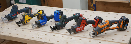

honestly as great as the multi tool is, it never is my first choice to cut anything if I can avoid it. The portaband as suggested or a cold cut blade, even a sawsall w/a fine blade if precision isn't a concern. I think most wood blades will do aluminum and maybe other non-ferrous metals but obviously you'd want a metal blade. Something like this:
one hand sawsall:
