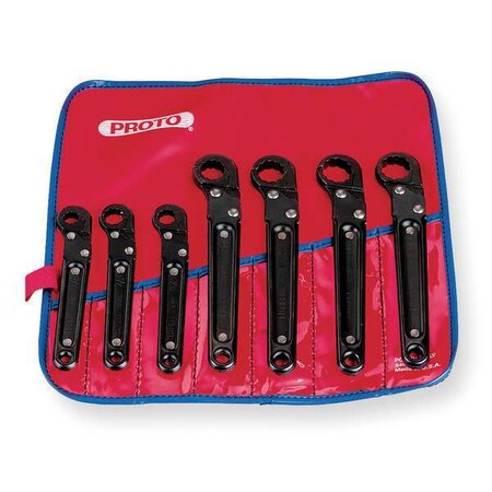

Anyone ever turn a 12 point box end wrench into open end wrench?
I got hydraulic fitting on my tractor the the arc is so small I can't even flip the angled wrench to do a turn. I have to reach around the axle, every flat. Took a long time to remove.
I did grind the wrench to make it thinner and will do some more of that. I can use a regular wrench to break or tighten, this is just for loose tighening.
I was also thinking of lubing the threads, with the hopes I an turn by hand a bit.
Do they make any open end wrenches that are like a sucker?
Thanks.

Now those are cool. I can get about one flat turned then I have to reach to other side and do the same. So I think this would do the trick.
Seems harder to find SAE. I need 3/4, but 19mm would fit.
Thanks.
Not 100% sure those will get over hose and union to get to the fitting I need to turn though

I've done it in a pinch. It usually weakens it to the point of being useless if you have to apply any kind of beans to it at all.
I was thinking of just doing it for the 20 some turns until it needs to be tightened. So in theory little force. Other idea was keep grinding body down, hoping to get enough arc to be able to flip wrench and turn again. Which I realize will weaken too.

I have an open end 12 point wrench by bonney. The outside ring is about twice as thick as a normal box end wrench. A normal box end with a piece cut out will just spread if the fitting is tight enough. If it already loose then sure go for it.

I cut one down and when i got to the point of final tightening, i was able to sneak needle nose vise grips in and "clamp" the improvised line wrench onto the flare nut. This kept the wrench from spreading and rounding my fitting. It actually worked pretty good.

To break the fitting loose, sometimes you can manage to sneak a hose clamp over the cut up wrench and line and get it tight enough to keep the wrench from spreading and tighten it down on the fitting (it's not ideal; it'll be sort of sideways and at an angle). Once the fitting cracks loose, then remove the hose clamp and proceed 1/12 turn at a time, uttering your most depraved maledictions toward the idiot who designed the machine this way...

12 point flare nut could be useful as could 12pt crows foot posibly but if purely for low torque turns then modding a ring wrench will work, just don't use cheapest junky ring wrench you got, find a decent one and preferably fairly chunky ring wall dimensions as it likely serve better in use .
